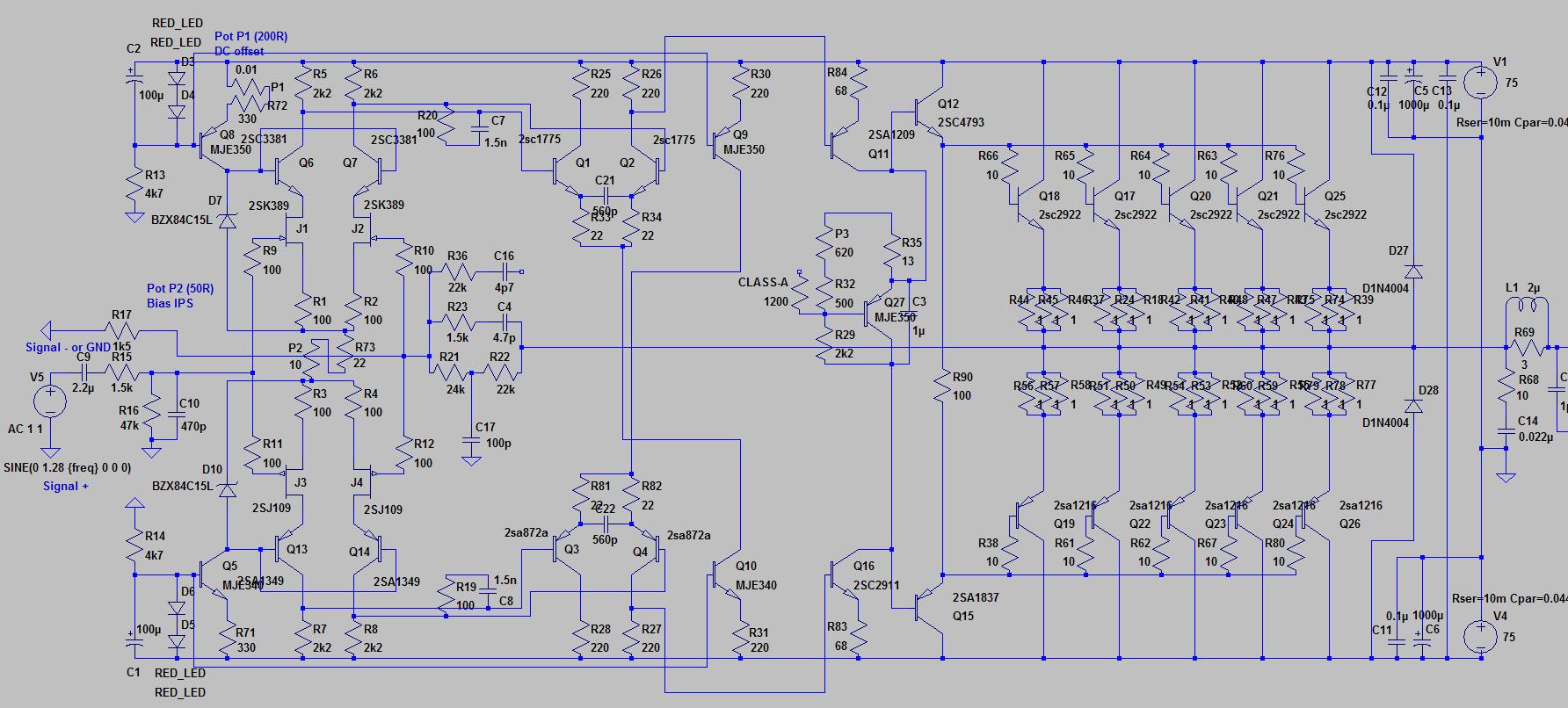

Thanks Mooly,
I see that both parts are from an other Hfe Group (R+S).
I realy would like to match the VAS transistors in order to minimalise the effect on the IPS (diff complementairy with dual JFET's).
I have to less experience to tell how important a good matching is between the VAS transistors.
Can anybody give me an idea whether this really makes a difference.

Maybe if you posted the circuit we could advise better...
Is it fully symetrical ? as I normal think of a single VAS device.
IPS: dual JFET cascoded with dual BJT
2nd compl diff stage
VAS BJT (I'm also thinking to put 2SK216 + 2SJ79 here?)
Driver
BJT OPS
I'm having all components except for good BJT's for the VAS stage.
Don't look to much to the circuit, I know it's a mesh, I'm still in the designing/trial phase.

Thanks for posting the circuit.
I honestly don't know what the ultimate effect of say badly mismatched devices might be but I suspect it will be small in the overall scheme of things. And you could always match devices pretty closely yourself anyway if you got a few of each.
Perhaps somebody else with more experience of this topology could advise you better.
