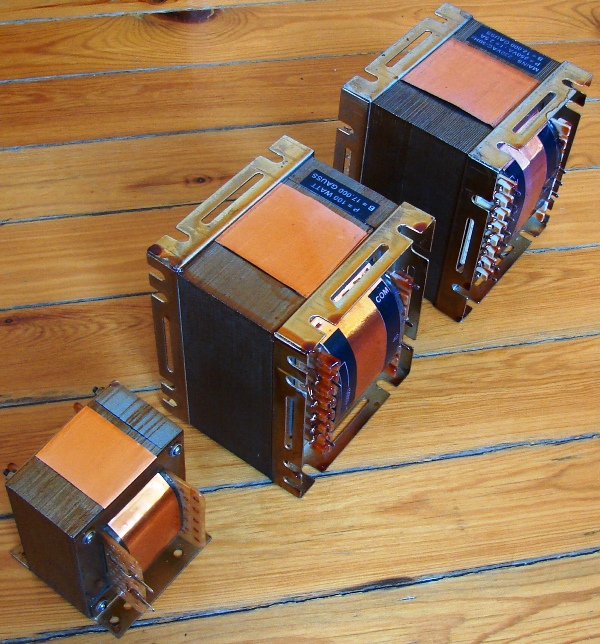

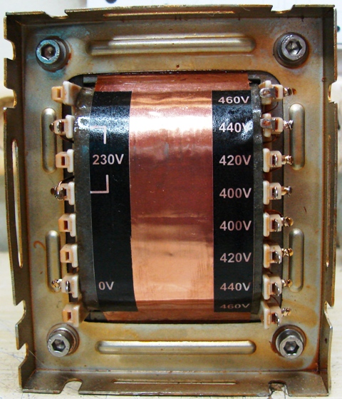

In the attached pictures are shown the transformers I’ve used in my SET amplifier which are made in Greece. In the left side is the 10H/310mA choke, in the right is the 350VA mains trafo and in the middle the most interesting i.e. the output trafo. Is custom made for use in a SET amplifier equipped with two parallel 300B/c (for Push-Pull use the windings of output trafo are different). The core of this trafo is made up from Si-Fe grain oriented laminates of 0.35mm thickness, its primary impedance is 1.5ΚΩ and its power is 100W (350mA max primary current) and offers both 4 and 8Ω outputs. The core has a B = 1.7 Tesla – though is not from Permalloy - and the primary voltage drop at full power, with load connected in output, is just 3 - 4 Volts. Primary is made up from 4 paralleled windings and secondary from 3 (or 4?) cross (or anti-parallel? I don’t remember) windings. It is a special winding method for SET amplifiers. All windings are made with 0.8mm copper wire (wrapped very tightly), for that reason the very small voltage drop. The core has a nominal bandwidth (as is given by the German constructor of laminates) from 10 up to 110,000Hz with a small lag (-2dB) at 60KHz. In actual test presents a bandwidth of up to 210KHz with a fall rate of -1dB/octave from 110KHz and above. At 210KHz the fall comes abruptly and the test signal falls by -60dB (if I remember well). The very good frequency response is proven in the attached FFT plot “Bandwidth -3dB” taken from the output of the SET amplifier at full power / 8Ω load. It is truly very linear from 10 up to 20,000Hz.
For the rest, choke core is made up from 0.5mm laminates and mains trafo core from 0.75mm ones and its B = 1.2 Tesla. In the second picture is shown the mains trafo back side with multiple HT taps (from 2 X 400 up to 2 X 460Vac) that i asked to have the possibility - in the future - to try different 300B, e.g. those with mesh plate instead the carbon plate 300B/c currently used.
The transformer laboratory is located at Thessaloniki, is well known among Greece as top for 60 years and accepts any custom request. E.g. in my case I asked fully impregnation of all trafos in epoxy varnish (is executed inside vacuum) and “Belly Bands” (though this of output trafo was redundant and caused some side effects so I removed it). Trafos are offered either with open fames or with black painted or nickel plated covers. On actual device mains trafo proven almost noiseless, the mechanical noise is very small and is audible only in absolute silence and only if you place your ear very close to trafo e.g. less than 10cm.
Vangelis Antoniadis, owner of the lab, is open to any request, very prompt and helpful (he helped me a lot because I am newbie in tubes). The lab is heritage from his father G. Antoniadis, he is electrical engineer and did 5 years studies in U.K. (I don’t remember the university) so Vangelis is very good in English thus you can come to understanding very easy with he.
A remarkable event (which is presented only in a Greek forum) was a side by side comparison of one of his output trafos with a corresponding of Lundhall. The performance of Vangelis trafo proven quite better. Additionally its price was the half of the 450 Euro that costs the Lundhall.
