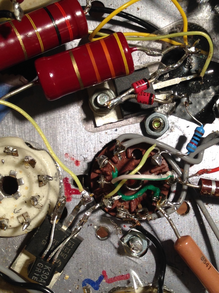

I have a CCS for the driver: I soldered a 2SK30 (selected pairs for 3,9 mA) on the source and gate leads of the DN2540. That connects with 820 ohm to the gate. Yes, 2x12V zeners to source on the pins... (not before the gate stopper.) So slight delta to Ale's CCS schema.

Can the deterioration of the CCS be due to the lack of a gate stopper on the DN2540 and 2SK30? (very HF, >1GHz)? Ale's diagram has those. But I have such a compact soldering . .
I took two pictures of the driver
- with IRF830 (first) & an active load (DN2540);
- and (second) with DN2540 & resistor.

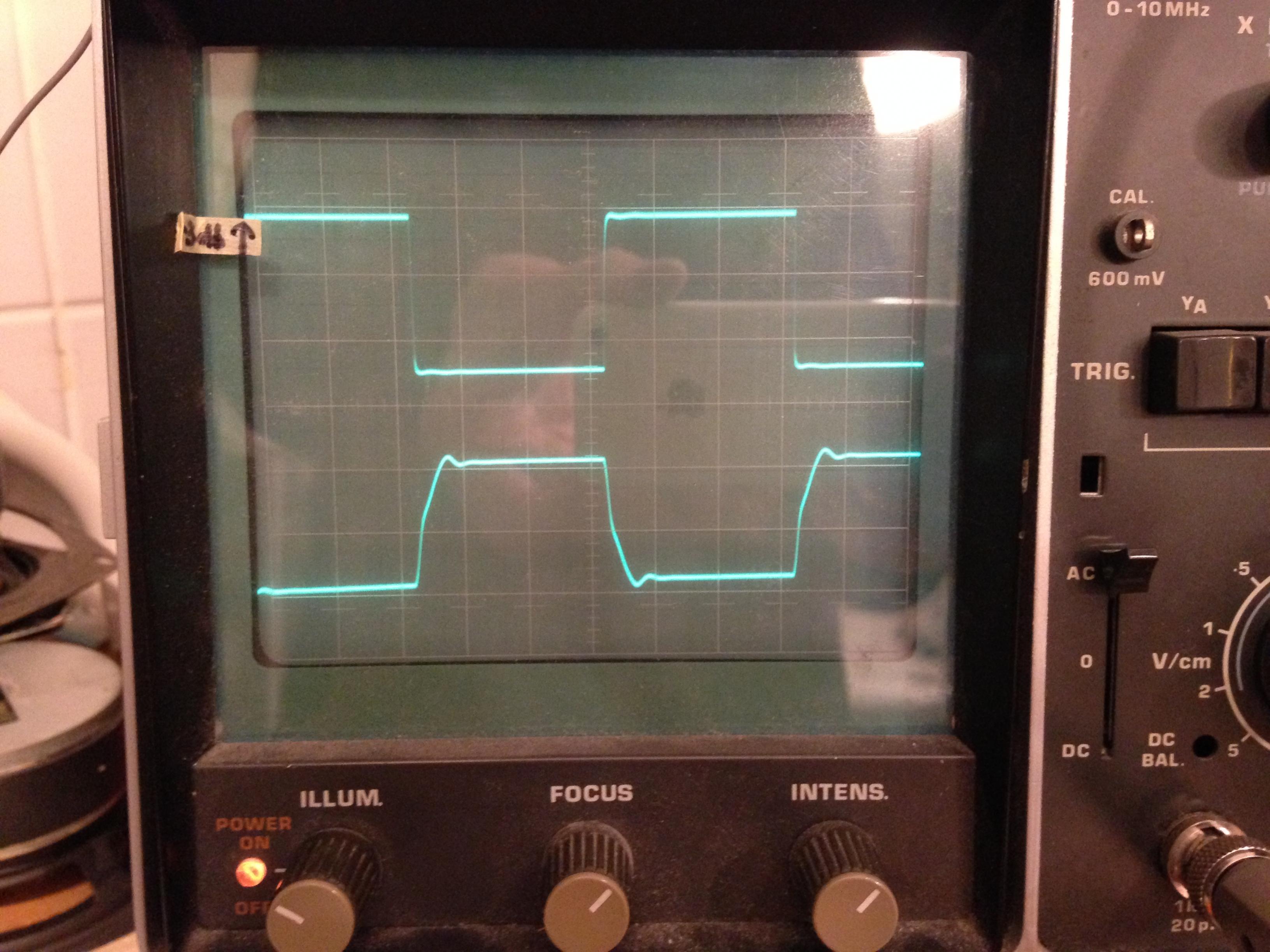

The first one has an incredible risetime, but that exposes the output transformer resonance that is about 176 kHz. (Lundahl 1k8); there is even a bit of crosstalk of that resonance through the earth as you can see.
The second one has a slower response but the resonance is less present.
For that reason I retained the second one.
Driver = 5751 tube in parallel.
IRF830 & active load:
DN2540 & 43K:
The square wave is at about 7 KHz
(I must say in apology there are the slightest differences in ground connection between the two mono chassis)

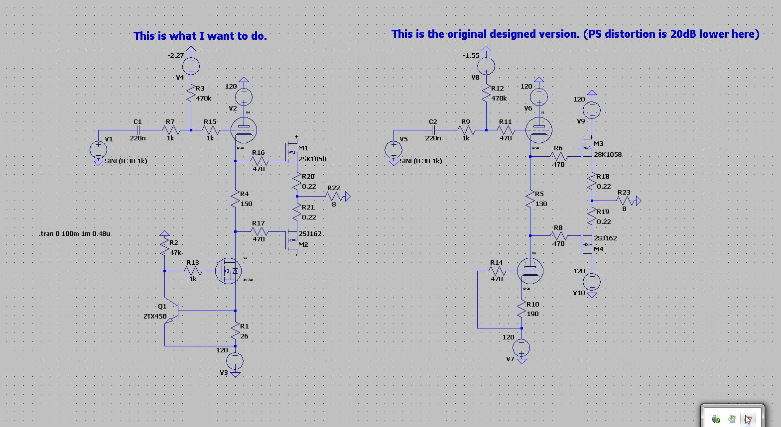

Hi Guys, I did see this thread and I want ask something, mine hybrid amp, designed long ago and still playing, it do already for 13 years without failing I want to change the driver part to the mosfets, now I use two 6n6p one as cathode follower and one as a current source, do send a signal from the dc servo to the input of the cathode follower, that does work however was it a good idea? in mine case voltage is positive from the servo, but can go two sides when needed to get low offset, this is because the mosfets on output get drived in dc mode, so uge offset is present when tubes are cold, for this there is also a dc protection with longer wait time, and get in when offset is below treshold.
I want more play for tubes, and as such do remove the lower current source and replace by a mosfet, impedance is then higher also..
Because I saw your conversation about current sources I do put it here, I do not want to hyack you guys.
