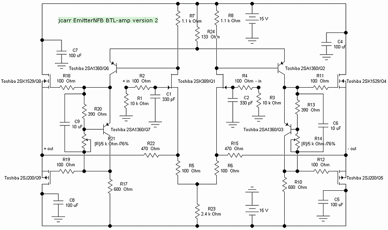

Interesting design, Jonathan.
If R5=R6=R7=R8=Rc and R3=R4=Re, then the vas stage differential current will be proportional to Va+Vb-2.Vout.(R22/(R21+R22)).Rc/Re
I believe there may be a simple connection error because as drawn the vas stages appear to be fighting with each other.

Traderbam:
The schematic was adopted from Onkyo's promotional literature. There _is_ more stuff in the schematic, like a BJT cascode for the second-stage, an extra follower-type predriver hanging off the second stage (before the Bi-MOS section), while the output stage consists of three PP pairs. OTOH, I didn't think that these were required to envision and understand the basic operation of this circuit.

Fred Dieckmann notified me that some of the component values in my original schematic were just too far out to be usable - like putting a decimal point on the wrong location. :-(
Here is a slightly cleaned-up schematic with what I hope are more appropriate component values. In the interest of staying with easily found parts, I replaced the current sources with resistors. But if you have access to a variety of constant-current devices, or are willing to roll your own CC circuit, the current sink under the input differential should be 6.4mA, while the current source feeding the second-stage should total 32.7mA.
BTW, my interest in the current thread lies in the use of global NFB through the emitters of the input devices. More specifically, being able to set one path for the input signal and a separate path for the feedback, without adding to the total device count. At this stage, I mainly want to understand fully how this method works. How the idea is applied, for example, non-inverting operation, inverting, feedback to the same side, feedback to the opposite side etc. is a topic of interest to be sure, but one for another day. Apologies if my initial comment about inverting-mode circuits was misleading to anyone.

This is a very interesting circuit, Jonathan, with strong aesthetic value. I have taken the liberty of sketching a simpler version of the same topology (hopefully) below, as an aid to wrapping our minds around it.
I look at it this way: If you split it down the middle, you get two mirror image gain stages, both single-ended "current feedback" types. By their symmetric nature, the junction between the two Emitter resistors on the first differential (input) pair and the Emitter resistors on the second differential pair will be at virtual AC ground for the case of an ideal circuit.
When we remove the idealness we note that non-common mode distortion/noise originating in one side appears at the Emitters of the differential pair, creating negative feedback for the side in question, but generating the same distortion on the other side in an additive way. However, at the same time we see that this additive distortion tends to be rejected by the differential connection of the emitters of the second gain stage. But this rejection also tends to inhibit feedback correction in the side originating the distortion.
You can see these effects by taking a copy of the schematic and introducing a "positive glitch" at the output of one half and then following through the whole circuit, noting amplification and changes in polarity as it passes through each part of the circuit. (This is how I spent years evaluating candidates for SuperSymmetry)
So where does that leave us? The performance will be very sensitive to the balance of values of the four feedback resistors in the input stage, and you may have to introduce some lossiness to the current source I1 or even just replace it with a resistor to get what you want.

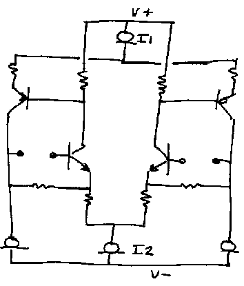

Nelson diagram and text in short
First I thought Nelson had published a new
Car-Amplifier.
To please some billions of Car-Audio Entusiasts in this World of highways.
But that will be a future possibility.
I am not the only one gettin' on the roll by this circuit, I see. 😉
Here is the principal diagram of Nelson's.
For to simplify the understanding.
/halo

jcarr - EmitterNFB BTL-amp - version 2 (revised)jcarr said:Fred Dieckmann notified me that some of the component values in my original schematic were just too far out to be usable - like putting a decimal point on the wrong location. :-(
regards, jonathan carr
with some alterations inspired by Fred Dieckmann 😎
I see that Fred has anticipated some of my thoughts and has addressed them.
This newer version will have a couple of things we want to pay attention to: It will want a balanced source for sure, and it will need a regulated supply, as our PSRR has declined with the replacement of the negative side current source with a resistor. It might be reasonable to reinstate the current source in this spot. Also, I would be inclined to put back some Emitter resistance on the PNP transistors.

Dear Nelson:
Your simplified circuit is conceptually spot-on.
BTW, the schematics that I have drawn up have been partly triggered by your "Monolithic SuperSymmetry" post. I liked the conceptual ideas, but I didn't like the high impedances that usually accompany shunt feedback schemes (unless you are dealing with low-impedance source components like moving-coil cartridges).
With the emitter NFB circuit, I wanted to propose an alternative feedback method that would allow the impedance of the NFB network to be reduced substantially without loading down the source component. It isn't an "X" or Monolithic SuperSymmetry circuit yet, but I think that this can be done. And in the spirit of the X and SuperSymmetry circuits, it felt proper to keep the circuit itself fully symmetrical - and simple.
So if someone wants to try to incorporate the emitter NFB idea into one of the "X" circuits or the Monolithic SuperSymmetry, that would be great! 🙂
>You get two mirror image gain stages. By their symmetric nature, the junction between the two Emitter resistors on the first differential pair and the second differential pair will be at virtual AC ground.<
And ideally those junctions should be very high impedance.
>non-common mode distortion/noise originating in one side appears at the Emitters of the differential pair, creating negative feedback for the side in question, but generating the same distortion on the other side in an additive way. However, this additive distortion tends to be rejected by the differential connection of the emitters of the second gain stage.<
Yes.
>But this rejection also tends to inhibit feedback correction in the side originating the distortion.<
Valid point, and one that I don't have a solution for (yet).
>The performance will be very sensitive to the balance of values of the four feedback resistors in the input stage.<
Agreed.
>you may have to introduce some lossiness to the current source I1 or even just replace it with a resistor to get what you want.<
My preference would be to keep it a current source. The revised schematic that I posted has resistors instead of current sources, but this is mainly because I was thinking of people who may possibly want to build the circuit instead of just think about it, and don't have ready access to current sources. If I build this circuit for myself, it will be with current sources instead of resistors.
>Very suitable subject for DIYers to experiment with.<
I hope so, and also one that I hope will be combined with other ideas.

As I have implied, these were issues I wrestled with for many years in the X development, and it is familiar territory.
By the way, you will note that the XA amps, and the Aleph X schematics on that thread incorporate Source feedback in a similar manner, but it is used only for common mode errors, ie absolute DC offset. This is done by reducing the values of
the Source resistances (in your case the 100 ohms) to 0.
