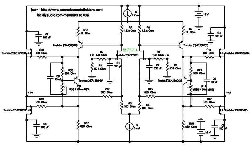

Since inverting-mode circuits seem to be gaining in popularity recently, I decided to post a circuit which is fairly simple and may be interesting for someone. The idea itself is old, but I don't see many circuits utilizing this method today.
The core idea is to use the gates/bases of JFET/BJTs for the signal inputs (per normal practice), but route the NFB loops through the sources/emitters of the same devices. If nothing else, this should allow one to utilize various inverting feedback configurations without having to rely on high-impedance series-input resistors for fear of loading down the source component excessively.
Obviously, this theme can be combined with many other ideas - complementary input stages, cascoding, active loading, folded cascode or current-mirror second stage, higher rail voltages, multiple output devices, etc.
No oddball devices have been used, and resistive loading has been used throughout, so it should be fairly easy to make. I settled on Toshiba for all of the semiconductor devices, and there are only 4 types of active devices used. Note I haven't built this yet, but I think that the values should be reasonably close to functional. But please be prepared to do at least _some_ tuning/troubleshooting/tweaking.
Apologies in advance for any errors.
regards, jonathan carr

I have put this interesting JFET-MOS-BTL-amplifier Circuit in my FTP-server.jcarr said:Since inverting-mode circuits seem to be gaining in popularity recently, I decided to post a circuit which is fairly simple and may be interesting for someone. The idea itself is old, but I don't see many circuits utilizing this method today.
Filename: jcarr_BTL_FET-AMP_v1.gif
It is in size to fit a 1024x768 screen.
I call it v1 - version 1.
Also have put - jcarr and his website URL - as added text into the image.

Halojoy:
>and the rest of the pack will come after you, if the amp doesn't work<
You are an excellent designer, my friend. Already you have deduced the reason why I set the voltage rails at +/-15V.
If you want to be careful, +/-12V could be an even better starting point... ROTFLOL!

jcarr Special amp
Here is Jonathan's interesting Amplifier!
😎 Balanced 2SK389 JFET in - Bridged MOSFET out !!!!!!!!! 😎
- What more do we need?
😉 Help Jonathan to modify and test it. Might be a real Classic Amp in time. 😉
larger image in the zip above
or at my collection below
/halo

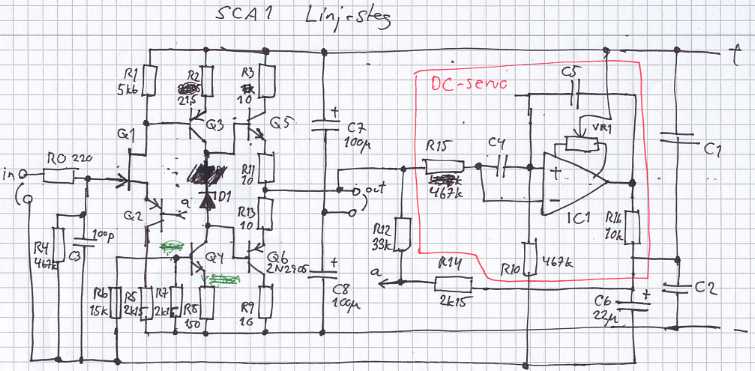

For the audio archaeologists, I found a somewhat peculiar
variation on this method when reverse engineering a friends
old preamplifier a while ago. Instead of feeding the signal back
directly into the source circuit, there is a BJT in series with the
source, and the feedback drives this BJT. Maybe there is some
good idea behind this, but it seems to me that this is likely to
introduce unnecessary non-linearities.
The design from the early or mid 80s and Sentec are not
even in the audio business anymore, so I guess I won't do
any harm to post my schematic of it. Note that I have broken
the feedback path in the drawing, and marked it with "a".

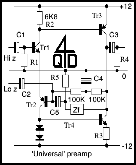

Here in a preamp version:
http://www.4qdtec.com/preamp.html

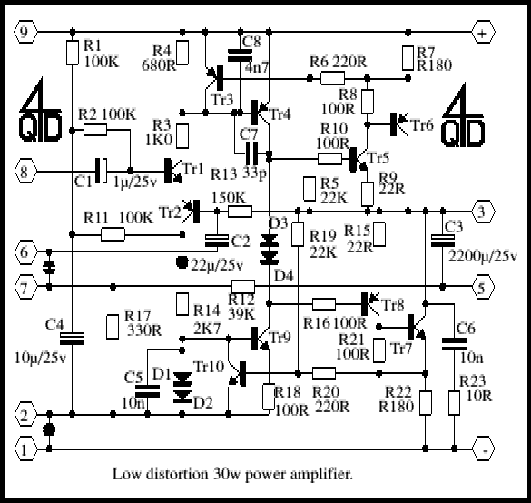

Same cofiguration used in a Low Distortion 30Watt PowerAmp:
http://www.4qdtec.com/pwramp.html

The same you can find as a general design-idea at 4QDTEC.
In fact the name 4QD refers to this basic configuration of amplifier.
4 transistors(Q) design.
The basic circuit princip, opamp, is found on this page:
http://www.4qdtec.com/opamp.html

Thanks Halo, I did not know about that site. Interestingly,
the site owner says about this design that "It is a circuit which
is original to me and I have never seen its like used elsewhere!"
It is not clear, however, if he "invented" it himself, or got it from
somewhere, this somwhere being the only place he has seen
it. Unless he invented it 20 years ago, it obviously was around
before, though.
He also makes an interesting remark that the input NPN and
PNP transistors actually form a LTP (diff. pair). Well, that seems
reasonable. It should be noted, however, that the Sentec
design I posted differs by using a JFET/BJT combination. It
pretty much boils down to the same principle, but it seems it
would have made more sense to use two JFETS then, or two
BJTs. I am sure there was some clever intention with this, though.

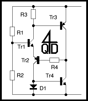

There are both possible advantages and disadvantages with this configuration of feedback.Christer said:Thanks Halo
The great poopularity of the longtailed pair is much due to the low offset.
This avoids the use of either input or output capacitor. Or avoids both of them.
It is also great for the input bias resistor, only to be connected to ground, common, in a dual supply circuit. (gives Power Supply Rejection without filters).
The idea of using one JFET and one BJT is to me obvious.
I have had the same idea myself, when I first visited
4QD-site some years ago.
If you select a current where g-s voltage is equal negative
as the bjt is positive (0.7 volt)
you cancel the DC-offset between input and output.
This means you can have the amplifier DC in DC out,
and only use one input resistor to common.
This is the hard part:
Of course you will have to find both a JFET and BJT smallsignal transistor, that work well
at that same current, with the same amount of opposite voltage drop.
jfet n + bipolar p
OR
jfet p + bipolar n

I don't quite see the advantage. It would be much easier to
match a complementary pair of BJTs or a complementary pair
of JFETS. The Vgs of a JFET at the operating point is usually
higher than the Vbe of a BJT. I never had a chance
to do any measurements on the amp, and I haven't tried to
calculate anything on it or simulate it, but my guess is that
the feedback signal would normally have a negative
DC offset in order to match up the Vgs of the JFET. It seems
to me that using a pair of devices with different characteristics
as a pair will introduce unnecessary non-linearities. Well, what
do I know. Maybe some of the gurus can figure out why they
did it this way.
did it this way.
advantages
Christer
I guess your judgement of this technique is the correct one.
If this was, from the HiFi quality aspect, a better way,
we would see lot of this in good amplifiers.
The advantage is probably more on the practical level.
And it saves some components.
At least in 4QD basic circuit, you do not need any separate constant current source. Saves some transistor and resistors.
But adds some capacitors and 1.2 volt DC-offset.

Better we get on track with the Original Subject:jcarr said:The core idea is to use the gates/bases of JFET/BJTs for the signal inputs (per normal practice), but route the NFB loops through the sources/emitters of the same devices. If nothing else, this should allow one to utilize various inverting feedback configurations without having to rely on high-impedance series-input resistors for fear of loading down the source component excessively.
Attachment: emitternfb btlamp #1.gif.zip
Jonathan Carr's special JFET MOSFET
Source/emitter global NFB amp
Jonathan,
Thanks for the schematic. I believe Primare also take feedback to the emmiters of the differential, in some of their amps.
I would like to know that if you apply feedback in this way do you gain any advantages in speed or distortion characteristics?

The configuration you see here with the emitters of an npn and a pnp connected in series is called a Rush Cascode, so named after an Englishman (I believe) called Christopher Rush, who devised this topology back in 1964.
It is also used to great effect in the NAD3020 phono amplifier, a legendary circuit designed by Tomlinson Holman, of THX fame, and still designing, now working for George Lucas.
The Rush cascode has interesting characteristics. It is quite difficult to use because it is lightning fast with huge gain. It does lend itself to using both bases as inputs, a la the stock diff pair, but its gain is so high it obviates the need for a conventional singleton VAS. Gain, and thus stability, can be manipulated with a small resistor between the emitters, typically dropping 200mV.
Using a Rush cascode, it is possible to arrange a single ended amplification block with global negative feedback with stage gain of around 8mA and Zout of less than 5 ohms. This gives it interesting prospects for a CD player analog output stage.......
Hugh
Hugh
