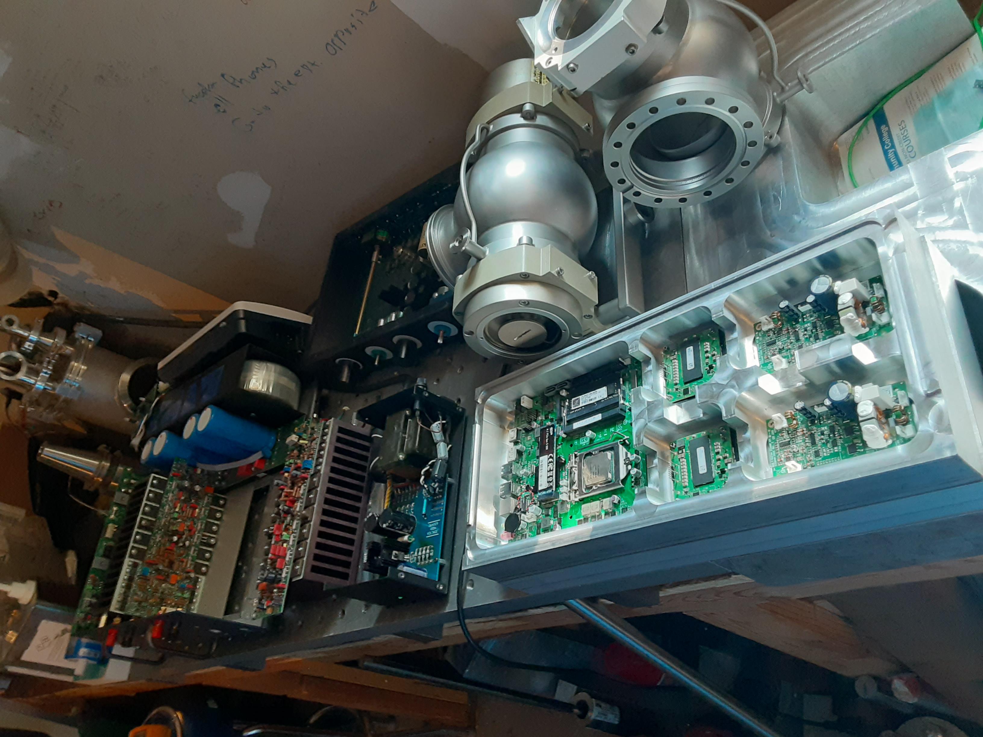

I'll attach a pic of the current setup meant for two Icepower monos. As you can see, the cleaner I can keep the connections the better-

@Extreme_Boky yes, it's a 1U form factor and it was inspired by some of the newer Jeff Rowland billet slabs. I just figured it would be worth while to fit more than an Icepower module in all that metal :D

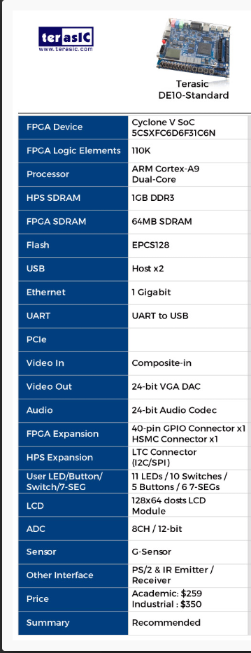

Could I make a Terasic Cyclone 5 Dev board work in place of the Spartan?
That FPGA board is by itself outside the budget you specified in post #1 ;)
Looking at the specifications of the FPGA, if I got the model right, I think it is more powerful than the one I used, so it should in principle be possible to rewrite the Verilog code and resynthesize it for this board. I have no intention of trying it, though.
