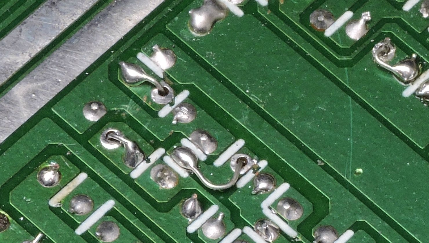

These amplifiers with this idiotic version of a double-sided board is VERY unreliable unless you reconfigure all solder connections for any lead that has solder on both sides of the board. This includes the leads where there is a pad on both sides of the board but no trace leading away from one of the traces. The best looking repairs will be where you solder the top side and then solder the bottom side of the lead to an adjacent point on the bottom pad. Attached is one example. You must do this for every one of theses types of connections or it will fail again. Simply resoldering them will only be a temporary repair.
When you receive an amp like this, you should either punt or factor in the additional labor required to do this the right way.
I will do as you suggested for all the jumpers and other similarly connected parts.
Thanks 🙏
