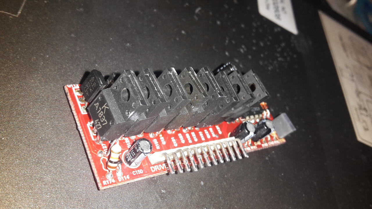

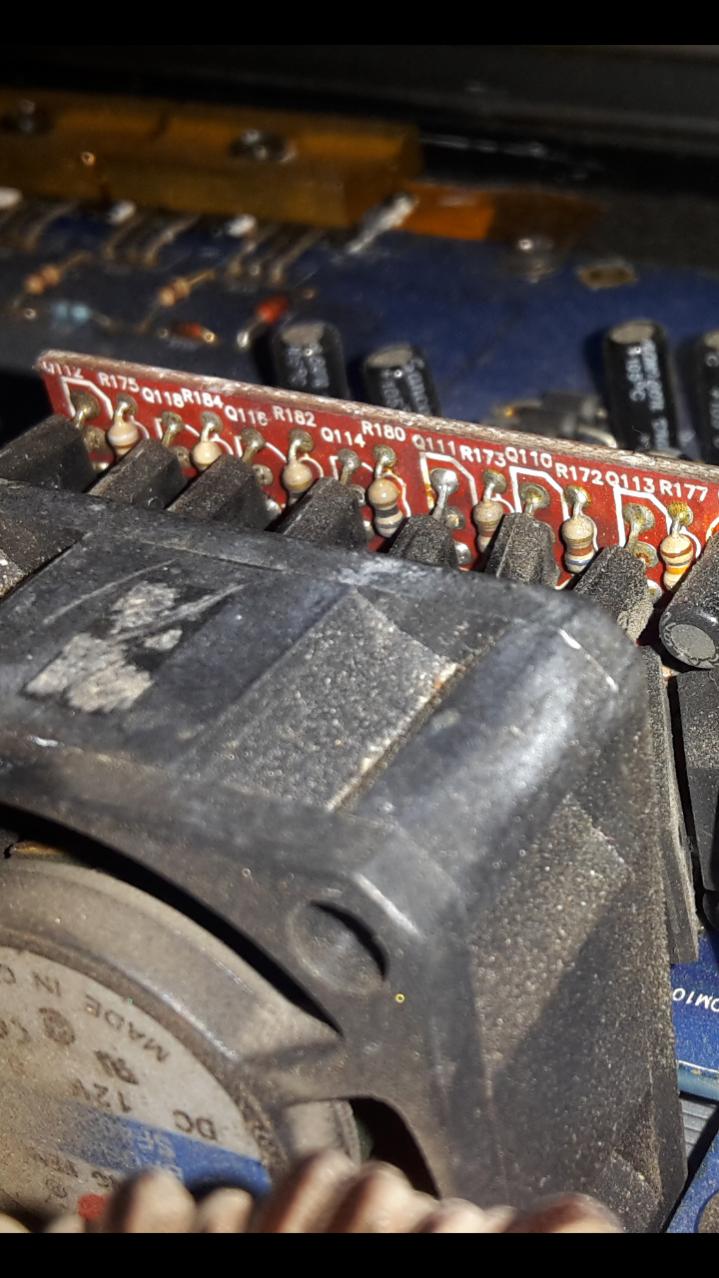

Now amp is in the chassis and seems working well.
I have to test with a charge.
Mje340-350 works fine, now with fan the temperature of low side pre-drivers is about 45-50 C.
In the high side there is only one transistor that become hot.
I change his position in the board from q130 to q134 and only this transistor is hot.
I think need to change but I haven't a replacement.
With insulator and lock it seems works.

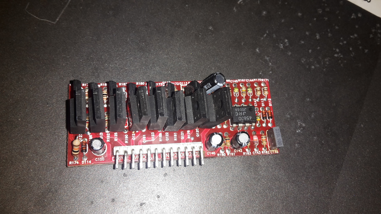

you will have the diagram of this driver board? I need resistors r192 r190 q124 q123, all burnHello, i'm repairing an xxx4000d driver board.
Now amp works fine but it has a bump when start sound and the small transistors (ktc3228-kta1277) become hot in 30 seconds after power on.
Is it right or I have a problem in the amp?
I think to replace small transistors with mje340-mje350
