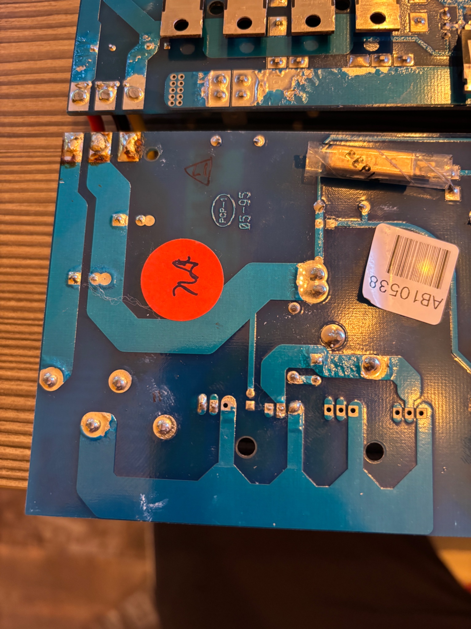

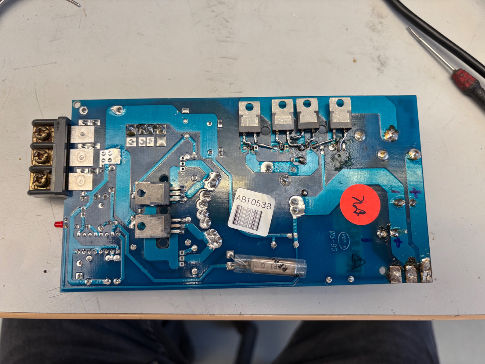

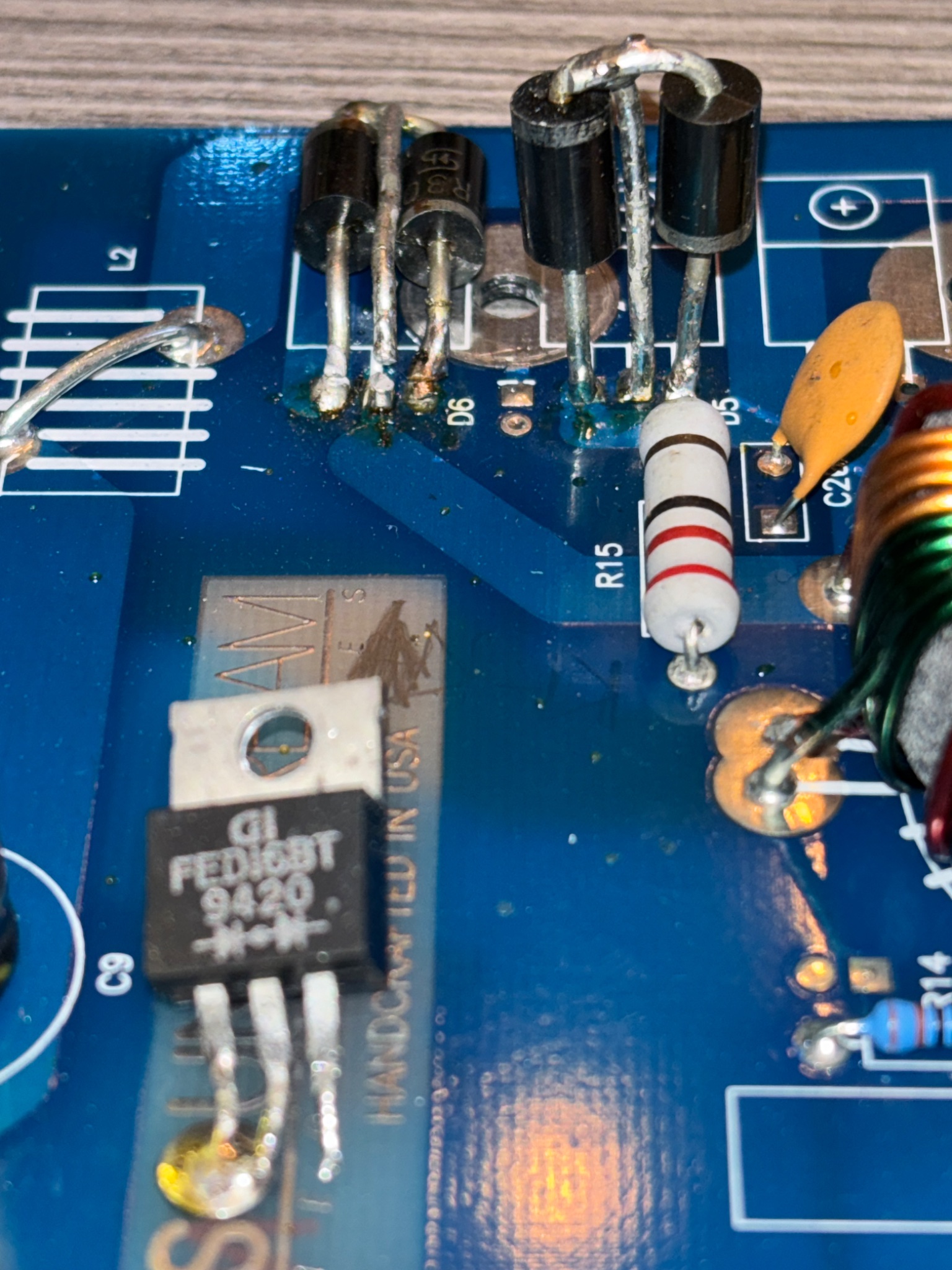

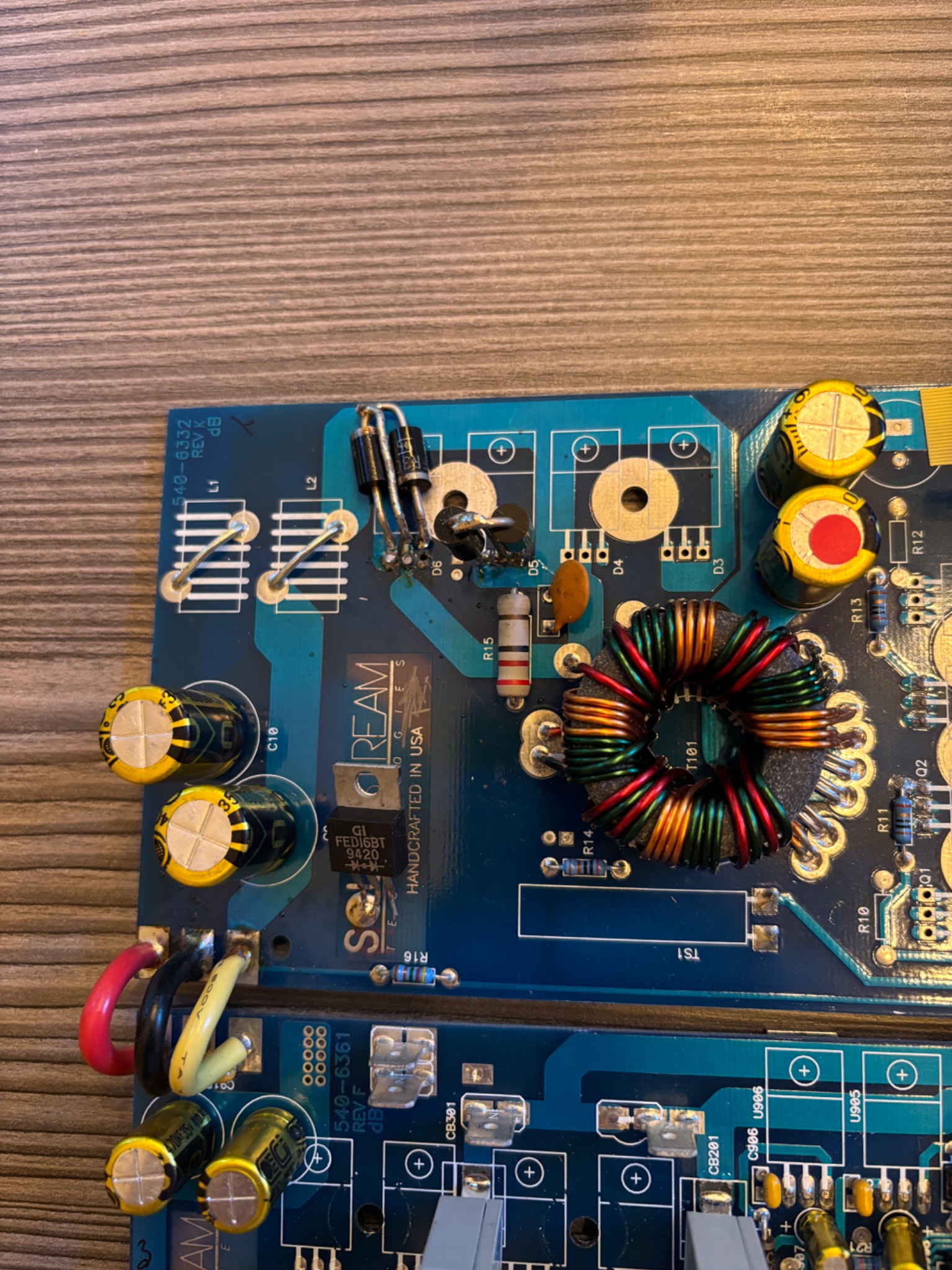

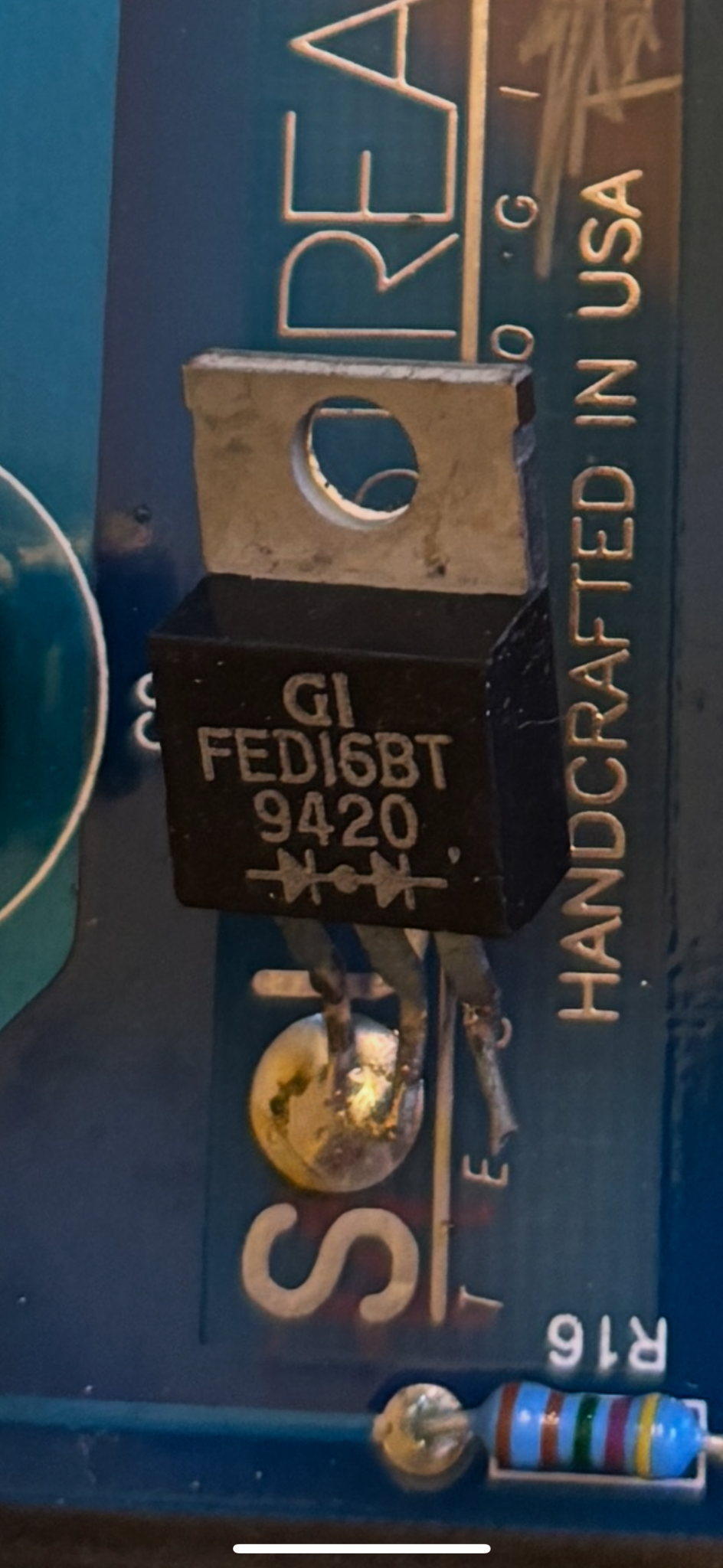

Hello all!
I have this amplifier…the rectifier diodes are replaced,i dont know why,but i see the FED16BT…is this the original rectifire diode?
D5/D6 are same FED16?

The replacement is/was the FEP16BTD. The B is the voltage. The last letter indicates doubler. I don't see any available. With the extra rectifier locations available, you may be able to use something like the MUR820 and hard wire some of the terminals to make the equivalent. You could do the same with the MUR1620CT or MUR1620CTR.
For future reference, high voltage rectifiers (and virtually other component) has a greater loss than their low-voltage versions. This isn't a problem here but just because the voltage is higher, that doesn't make it better.
That said, here, 4 TO-220 packages will better dissipate heat than the originals.
