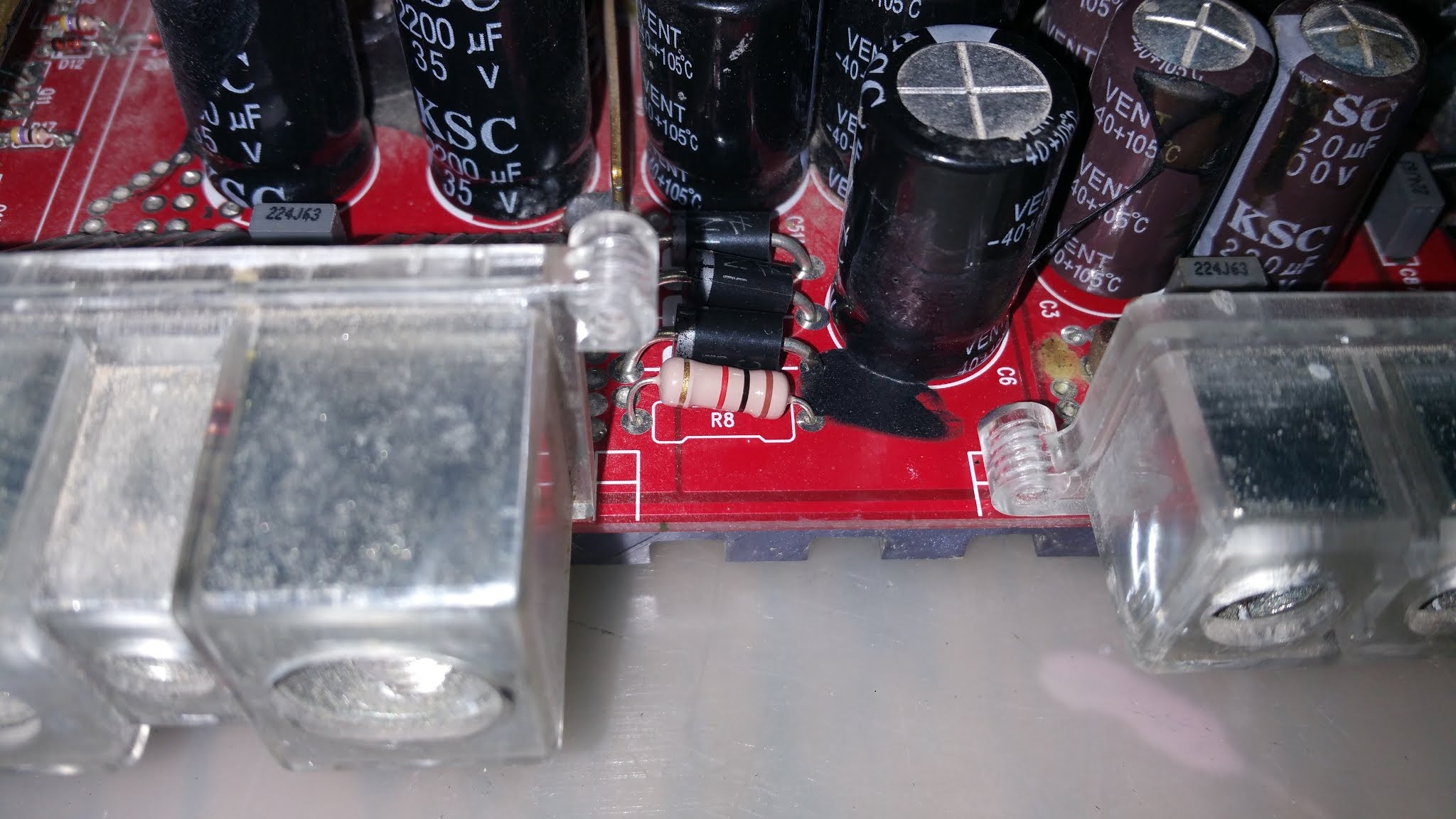

I just started to rebuild the power supply in a Rubicon 2500.1 and I found a burnt resistor. R8 anyone know the value of the resistor that belongs here?

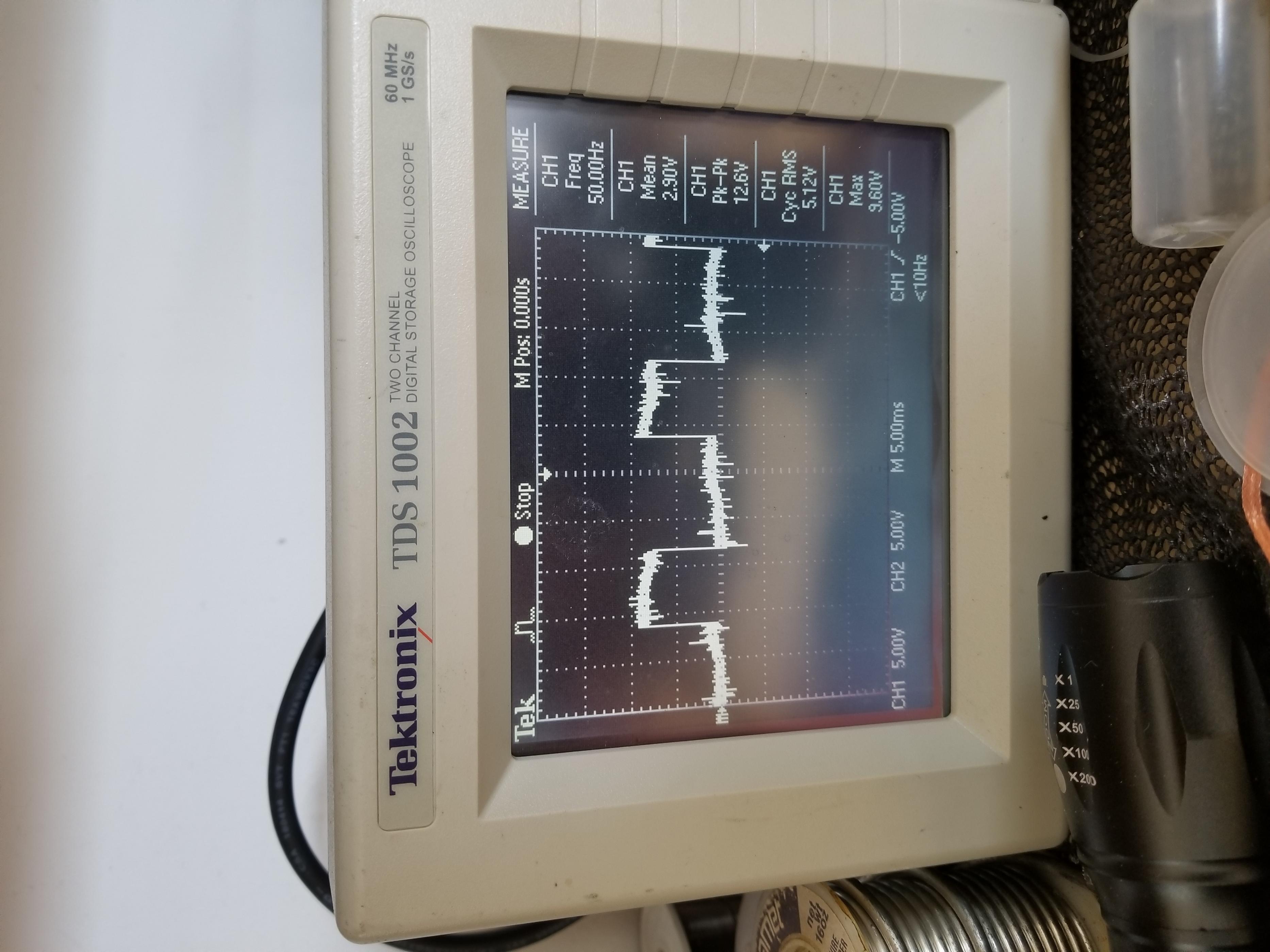

Question, if I see the 50hrtz on all the gates of the output transistors, drive is present. Withing a few seconds gain is all the way down the high side output transistors heat up, I tested all the driver transistors, in tester and with ohms for leaking. Would it be the torrid, one looks raised? Or the octacouplers?

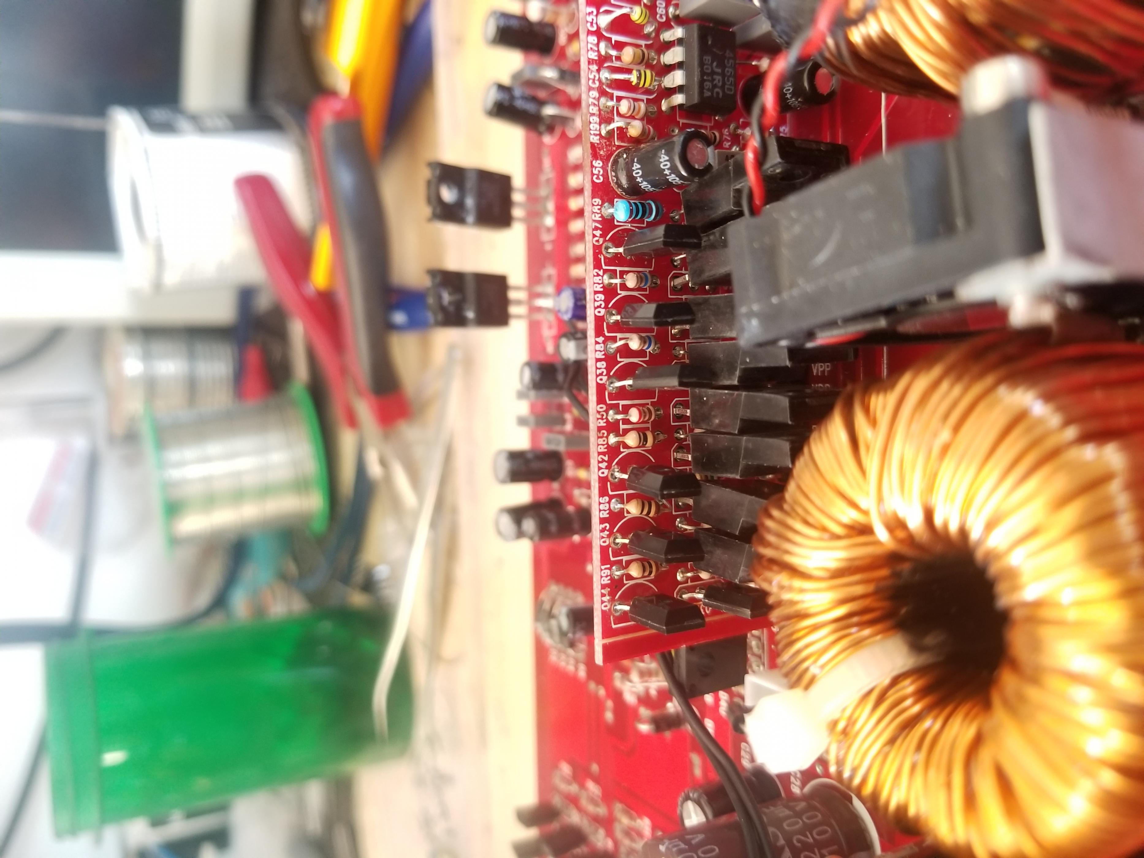

Could use help, the driver transistors heat up quickly as well. The a1277, c3228. Replaced them still the same. The noise is only on this amp.
I did get the octacouplers u suggested perry.
And a new set of irfp264.
I pulled one leg of all the gate resistors and tested them and the diodes, all within tolerence.

Many amps use this basic design. There are fewer that use the board with the TO-220 drivers. The Planet Audio BB2400.1 uses this driver board. I don't know of any manufacturer that will sell the boards. You may find some on ebay.
The forum member jacampb2 may have something that you can use for testing.

That should be fine perry just going to order a working unit to make comparisons to. I used the octocouplers you suggested and they worked. It stopped the small signal drivers from over heating. But the high side output transistors still heatup within 10 sec of turning on the amplifier. Same noise appears right at the RCA? I found that someone repaired the underside of the rca grounding leg with soder. So I reworked that connection. Still the noise persists
