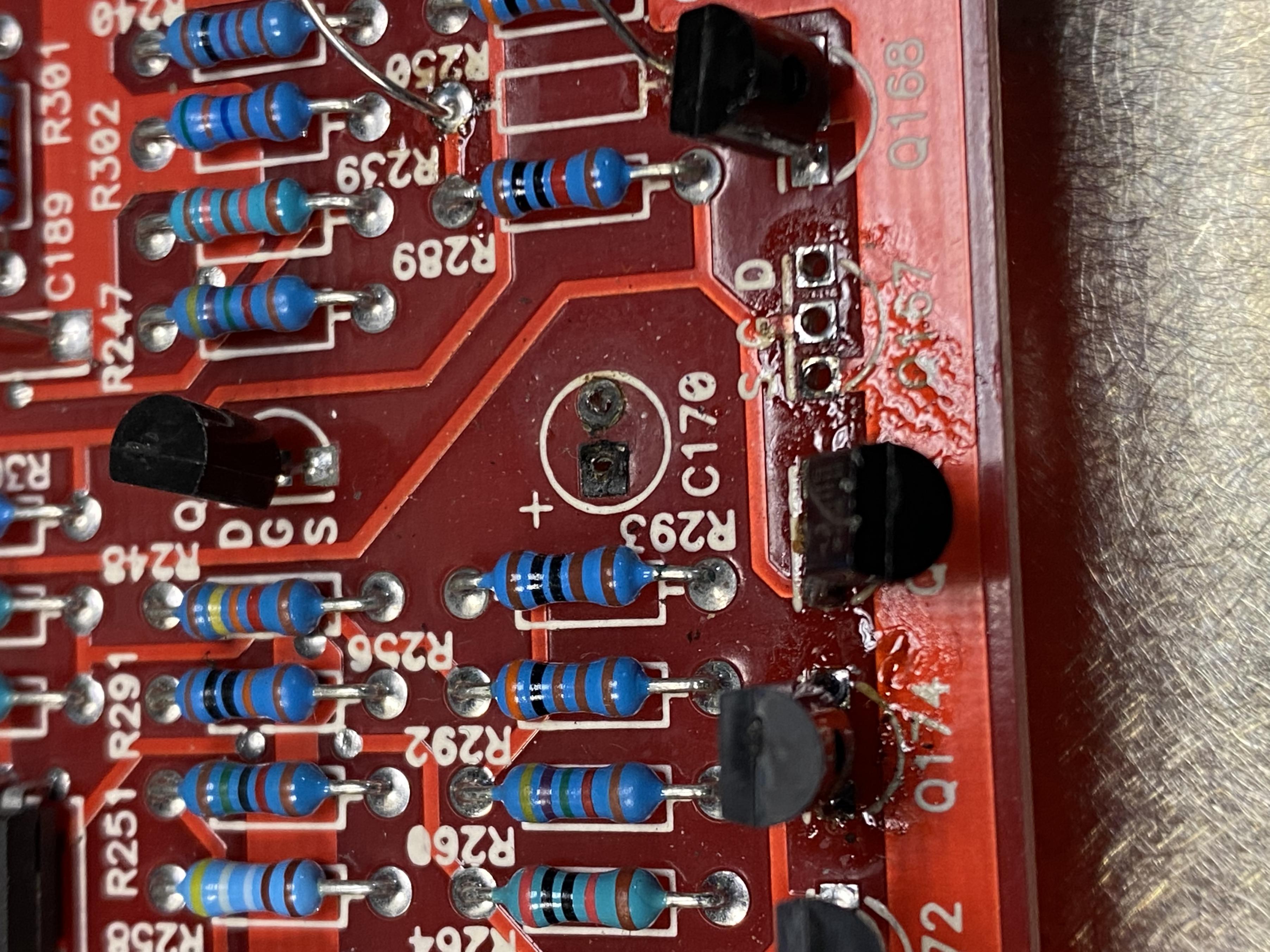

Shine a bright light from the back of the board to confirm that there is no dark area between the pads.
If there is a ground plane or trace on the other side of the board, remove Q167 and R260 and confirm that the resistance between the pads is infinite (OL).
On the pads for Q167
Drain to gate :OL
Drain to source: OL
Gate to source :7.25 M ohm
Replacing the cap didn’t change anything
Drain to gate :OL
Drain to source: OL
Between the pads for the caps the reading is in the mega ohms and when looking at the readings it seems like it’s charging another cap .
Did you try to look for a shadow with a bright back-light?
There may be contamination from electrolyte.
Amp will not produce audio with all parts installed .
I don’t have any MPS8099’s on hand to see if they are the fault .
Wondering can I use MPSA06’s in there place ?

Replaced Q174,187 with MPSA06 in place
Of the 8099’s.
All parts are installed and amp has output .

Base and collectors are different MPS8099 vs MPSA06. Will need to twist-swap legs 2-3 on MPSA06.
I CANNOT confirm if MPSA06 can electrically replace MPS8099 but they do look similar on paper. If it's working then maybe?
I recommend if you DO buy MPS8099, to ALSO purchase MPS8599 - which is 8099's complement. Soundstream amps use both of these around muting and also auto-current circuits. I have a few of each 8099 and 8599 I could spare, but I dont have a lot. Hard to find I think.
