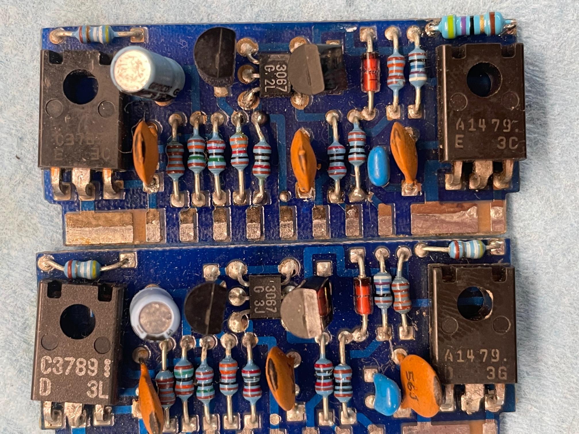

Thats when I found two issues. On the problem channel, the 49.9ohm resistor (R221) going to the 2SA1479 was blown open. The 1479 is testing identically from board to board so it *may* be OK.
and THEN I noticed a possible manufacturing flaw. Take a look at the attached photo. On the Top RIGHT board you'll first see I installed a 47 ohm in place of the failed 49.9ohm as that is what I have on hand. Then, just next to that 1.33k and 976 ohm resistors. Now - take a look at the BOTTOM driver board - same resistors.
The board on the top seems to have these installed backward. I'm going to swap the resistors back.
Could this mistake have caused this amp to fail - ie R221 to blow open, and then blow all the way back to the PS? What about all these driver transistors - suspect?
I don't think that that factory defect could have caused the amp to fail.

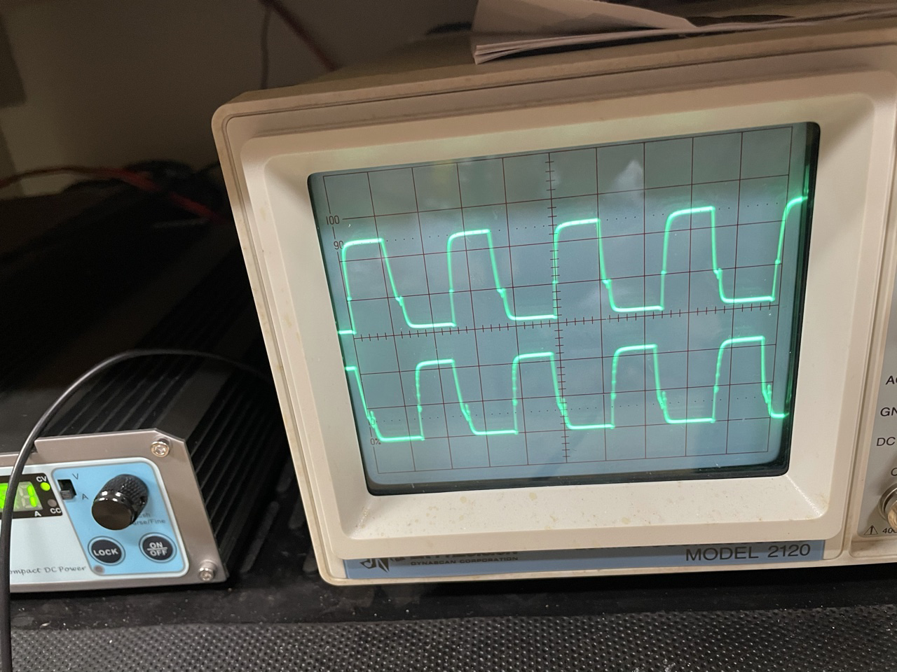

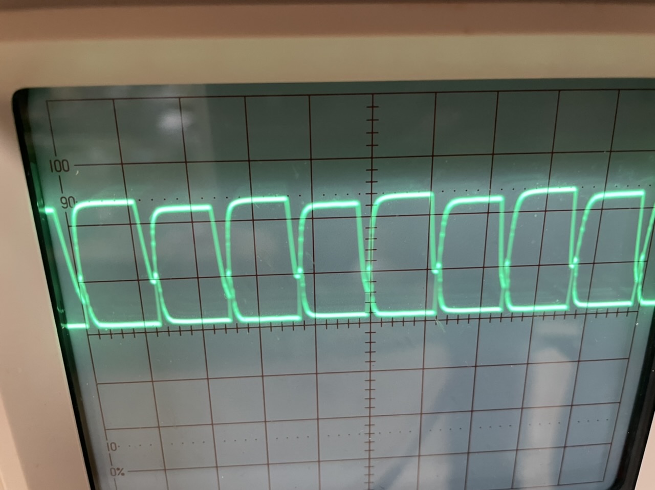

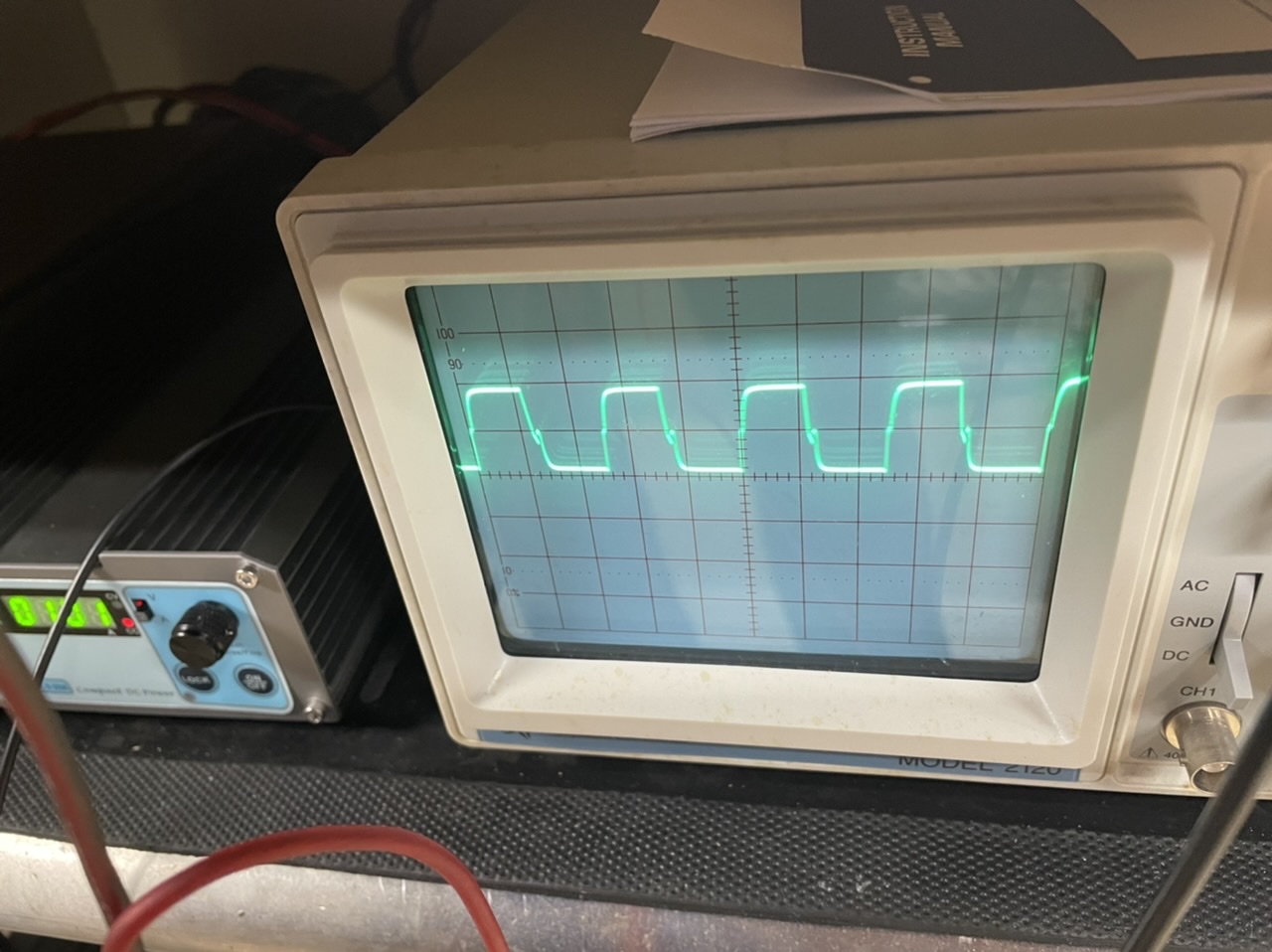

With my scope, pins 11 & 14 from the SG look good all the time. On the gate resistors however theres a bit of a notch going on.
Are 47 ohm resistors not low enough to drive the IRF3205?

R105 and R106.
Before I read your post, I changed out the 47ohm gate resistors to 10ohm and the amp powers with only .7A draw. Fets stay cool-er.

There are multiple solutions. If yours works, that's likely good enough. It's a bit harder on the drivers but the drivers you used should have no problem with the load.
