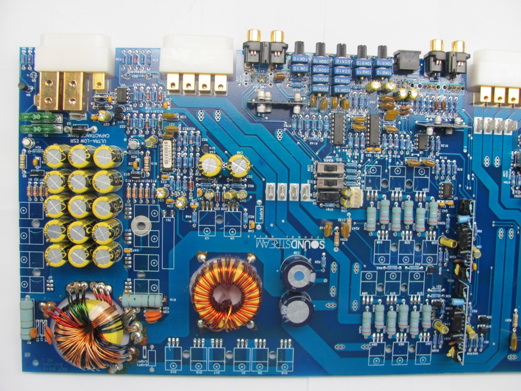

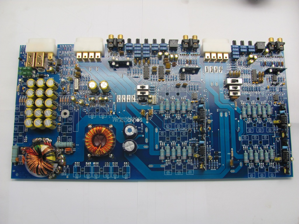

I pulled my old Soundstream Reference 644s out of storage to put into my 70 Mach 1 only to find that speaker output on Channel 2 doesn't work. What I find strange is the voltmeter measured 0.06V on Channel 2 but the amps read 0. I measured all four speaker outputs and Channel 1 measured 0.06V, Channel 2 measured 0.06V, Channel 3 measured 0.03V, and Channel 4 measured a little over 0.04V. I pulled the heatsink off to inspect the board and didn't notice anything burnt up or loose. The speaker wires were not getting a bad connection, as I verified the set screws looked fine and was pressing the wires correctly.
Can anyone knowledgeable with these amps walk me through things to check so that I can get it up and running? I noticed member 1moreamp seemed quite knowledgeable on another thread with someone having problems with an old Soundstream board.
The first thing you should check on SS amps is the switches (all switches, top, bottom, side...). With a speaker connected to the dead channel and signal feeding the left and right inputs for that half of the amp, move the switches back and forth repeatedly to see if audio every plays through that channel.
Perry has the correct direction for you to pursue. If its not the switches its likely bad solder joints on the driver board for the dead channel. Very rarely is it anything else causing the issues your describing.
Take a look see and you can try wiggling the driver FEB board for the suspect channel to diagnose bad solder joints. let us know what you find... 😉
I did the switches just as Perry suggested, and no sound still came out of Channel 2. I looked at the FEB board real close and all of the soldered joints looked solid. I removed the mainboard from both heatsinks and inspected the backside of the FEB board and it also looked good. I then installed the mainboard back onto the base (which is a pain in the rear getting the LED and switches to line up!), hooked up everything with the top heatsink off, and wiggled the FEB ch2 board and still no sound.

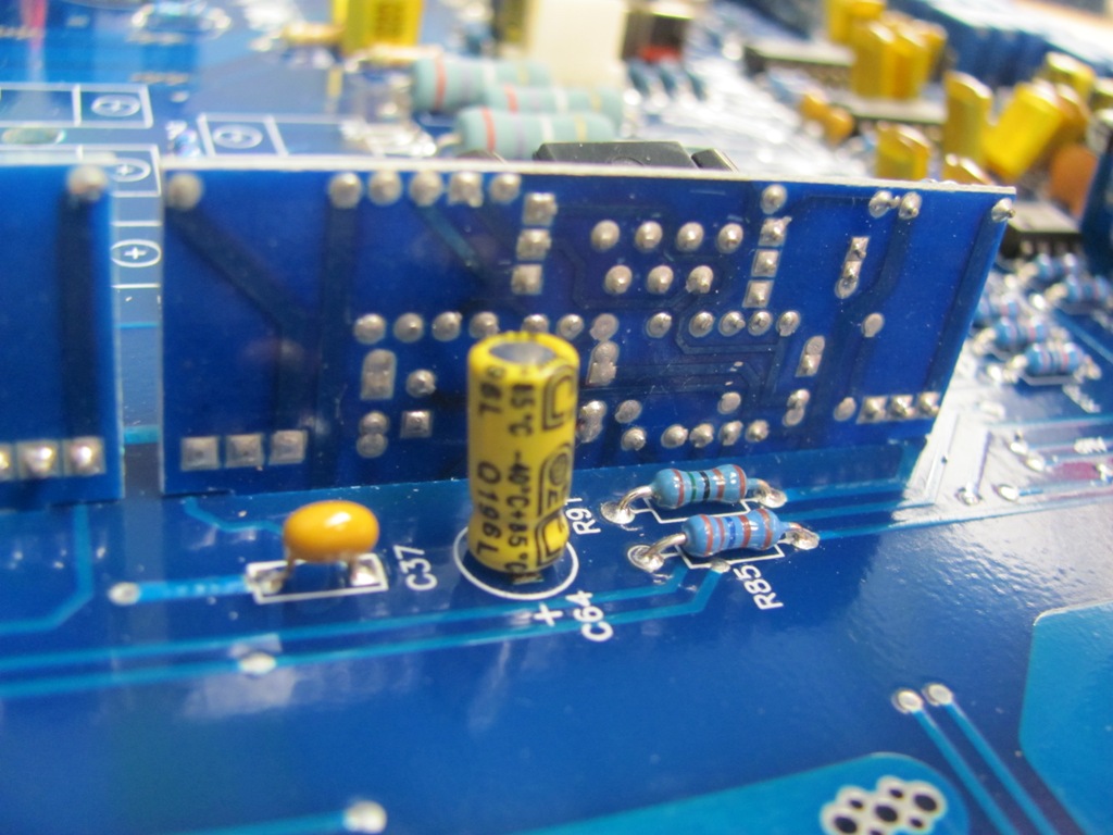

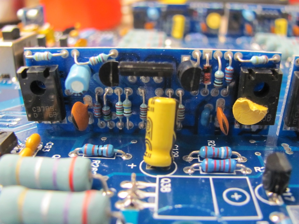

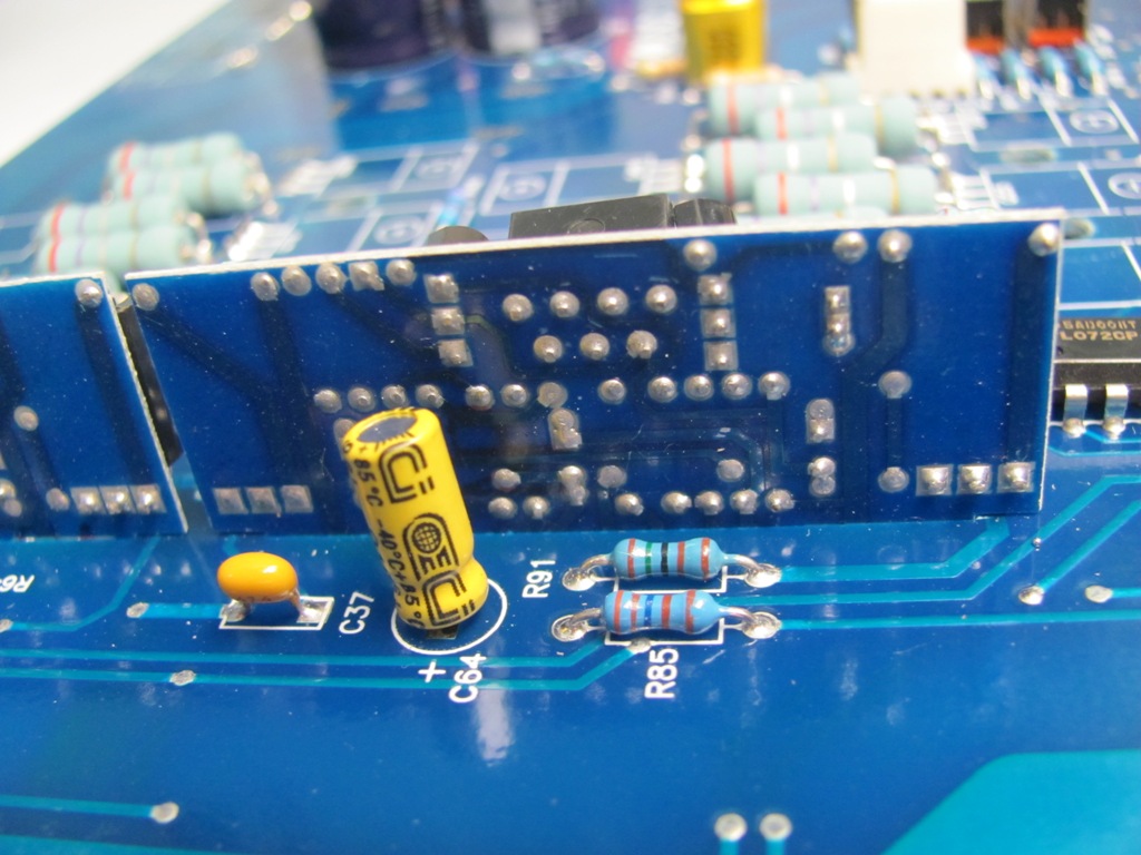

Are there common things that go wrong with the FEB that I can inspect, short of weak solder joints? Can I test certain resistors or items on the FEB to ensure that is the problem? Attached are some pics. I have higher resolution ones but am limited on the size of pics I can attach, so I could email them to anyone should it be needed. I really appreciate the help thus far!!!

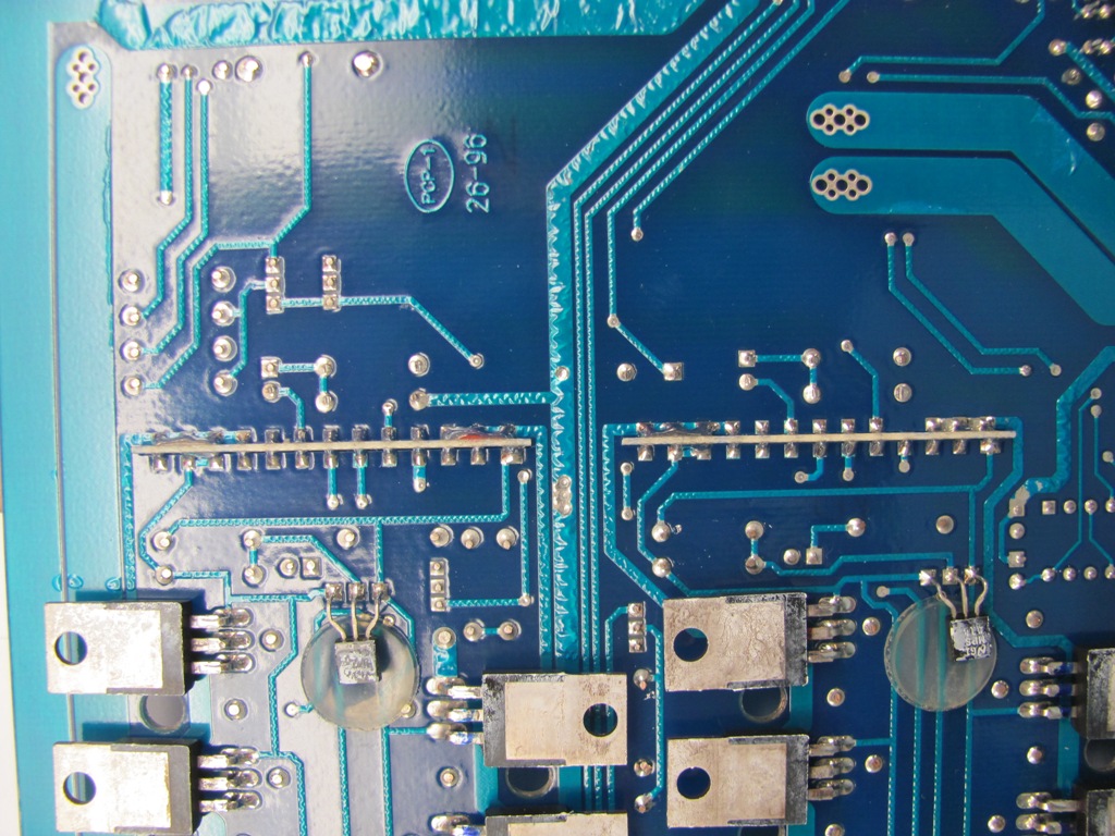

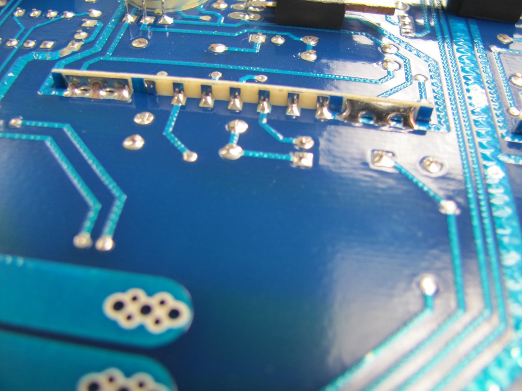

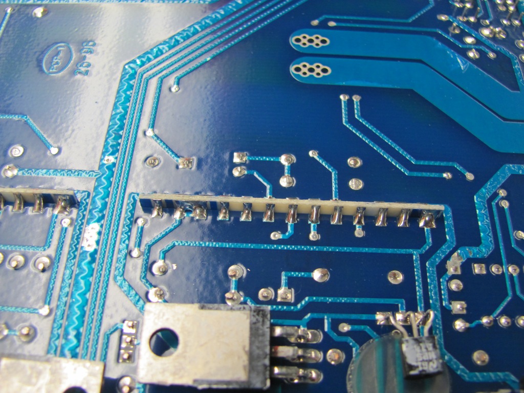

Also, something I noticed is if you look at my second pic (back of the FEB board) you will notice pin #4 doesn't have any solder on it. None of the other FEB boards are like that. There doesn't seem to be a track on the main board for the solder to even go to. Just thought I'd point that out. I also noticed none of the FEB boards are labeled on the main board like the resistors and such. I traced the #2 channel to the FEB board I took pictures of, which is the FEB board nearest the center of the mainboard.
Not sure what happened to my pictures. See attached

Sometimes, and I do stress sometimes the switches do not register even with jogging action. They need to be removed and cleaned or replaced. JandRelectronix on ebay has them. use this link:

See post #5. Pics should show now
Are there particular switches that cause this, or can it be any of them? There are 13 of them total. On top there is:

For example, I wouldn't think the Line Out or anything regarding CH 3 & 4 would affect the speaker output of CH 2 would it?
Could contact cleaner sprayed into the switch help? Is there a way of testing the switch from the terminals on the back of the board?

Any switches designated for the channel in question can cause this symptom. Yes contact cleaner could possibly help. I have removed the switches and disassembled them cleaned them and reinstalled them before, but replacement is the fastest way to go.
As for the solder joints, they can be difficult to see visually as weather or not they are good. I just touch them up with a soldering iron and possibly add a little more solder to each joint. This amp has preamp boards also < the two little vertical board facing the gain pots. These can fail and Jaime at jandr has them. I would retouch those solder joints also.
The solder reflow is the simplest and fastest to do and then retest. If the problem is still present its most likely the switches or one of those preamp boards. Not much else every fails on these REF series amp. The only other time I saw something similar and it was not the issues listed above it was a bad RCA solder joint on the center pin conductor...

well, solder joints on the boards can be nearly impossible to see, even with a magnifying glass. often times, i need to dig the sharp points of my probes in and run from one end of the solder joint to the other to find that there is a cracked connection..... That being said: in your first 2 pics, i do believe i see several cracked connections, which means you need to Replace the solder joints on all the little upright boards (feb/inversion/etc). i mention to replace the bulk of the solder in the joint over just re-flowing it, due to the fact that it is highly oxidized inside the crack, or it would still be able to make contact. i always throw some nice "silver solder" in there for durability. these little boards have got me more than once, lol. also, it could be either the feb for the channel, or the inversion board, and i cannot stress enough not to power it up without the power supply clamped to the heatsink, even just an idle.
1moreamp, so I guess that narrows it down to 5 possible switches? I never thought to check the preamp boards so I'll check them this evening.
AKHeathen, its tough to get a decent picture of a curved solder joint due to light reflections, but under a magnifying glass I don't see any cracks in the FEB to mainboard joints so it must just be reflections in those pics.That doesn't it isn't separated under the surface as you have mentioned.
Interesting thought about replacing the solder joints instead of touching them up. That would be the proper way to go about it. I don't own a solder pump (thanks Perry for the amplifier repair link!), so I guess its time I get one? Do you use one AKHeathen?

What are the inversion boards? Are they the little pre-amp boards? I'm an engineer (structural) but not an electrical engineer, so I'm learning a bit about this stuff still. I did stay at a Holiday Inn Express last night though 😉

Something is definitely loose either in the noards or the switches. While bench testing the amp over lunch, i tilted the amp up to look at a switch and the speaker sound kicked in. I went to lay it flat and the speaker cut out. I have not been able to replicate it again, even by shaking the amp vigorously. I used contact cleaner on the switches but need to test them after it dries
If there are bad connections on the driver boards (or anywhere else), it's my opinion that you need to add new solder, remove all of the solder and re-solder. This is the only way to know with 100% certainty that you removed the layer of oxide. If you don't remove 100% of it, the joint will fail again.
As it was mentioned, it's easy to damage the pads for these connections. When heating the solder, do not apply pressure to the pads with the tip of the iron. Allow the iron to melt into the solder but hold it so that it never touches the pads. The solder will conduct enough heat to allow all of the solder to be heated and removed. When applying new solder, you will have to touch the pads but you should apply as little pressure as possible.

1moreamp is absolutely correct about the feb boards needing the solder work. I did it to a ss 405 that has two channels cutting on and off with bumps or taps on the chassis.

New development over lunch. On the test bench I was poking and prodding the FEBs again hoping yesterday was a fluke. I then pressed on the mainboard next to the FEB and voila! Sound cut in as long as I hold the mainboard down. This has in fact, in my opinion, solidified the cause as being weak joints on the FEB-to-mainboard. Now to get a solder sucker and begin the resolder 🙂 Thanks everyone for the help!
1moreamp told me about those reflowing solder joints,i didn't believe him at first because they all looked okay/good. But i went ahead and redid all the feb boards and viola .... No more cutting on and off on any of the channels. This is something I'll remember from now on for when i do run onto another soundstream amp.
