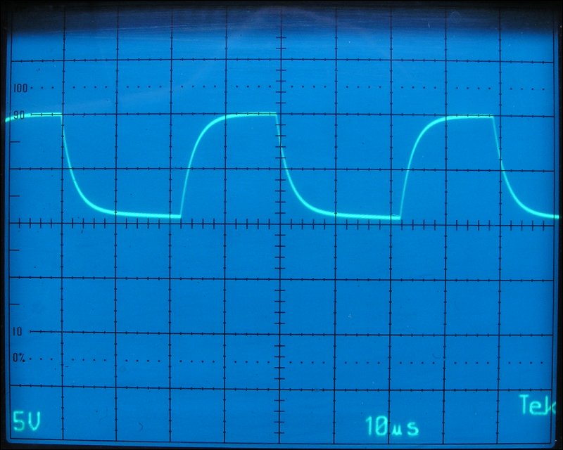

Check the drive with a loading capacitor (FETs out of the circuit).

When checking the drive, the drive may look OK because there is no load (as there would be with the FETs in the circuit).
Connect a small capacitor (best in the range of 0.1 and 0.01uF) across the gate and source pads of the PS FETs. You should see something like the attached waveform. This was taken using a 0.047uF. Do this with no FETs in the circuit.
If you have the tutorial, it's covered on the Tech Tips 9 page, item #23.
