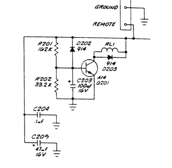

Hi guys, i have one Soundstream MC120 with power ON and power OFF pop (bump).
It's normal for this amplifier?
I don't found MC120 schematics, maybe MC245 is similar?
Thanks in advance
Thanks in advance
Hi Perry, yes i have 245 schematics. Should be similar.. the 140 don't have anti-bump circuit, right?
Some older amplifiers had a slight turn on/off noise. I don't know how severe this one is (would have to hear it in person, not on video) and would have to have experience with that specific model. I can't help there. Maybe someone who knows these old amps can help.
Yes i know, for example, HK CA260 have pop when turn on, and this mc120 have the same level (approximately), this is the first old soundstream on the my hand..
Early CA, D, and MC series without the output relays had the pop/bump. Later models had a relay which delayed the turn on and opened the output with the remote terminal.
Here is some info in Post#23:
Hi everybody,
Recently I just bought a used SS amp MC 245. It has a little problem with the pop noise ONLY during on and off. However, the popping noise come from all channels EXCEPT the subwoofer output. I noticed that the sub out has its own relay, but not so for the other 4 channels. Anyone be kind enough to guide me to trace the culprit??
The DC output are small, but still it's annoying. Across 4 channels, it puts out 0.4 - 0.5 v. Help😀
