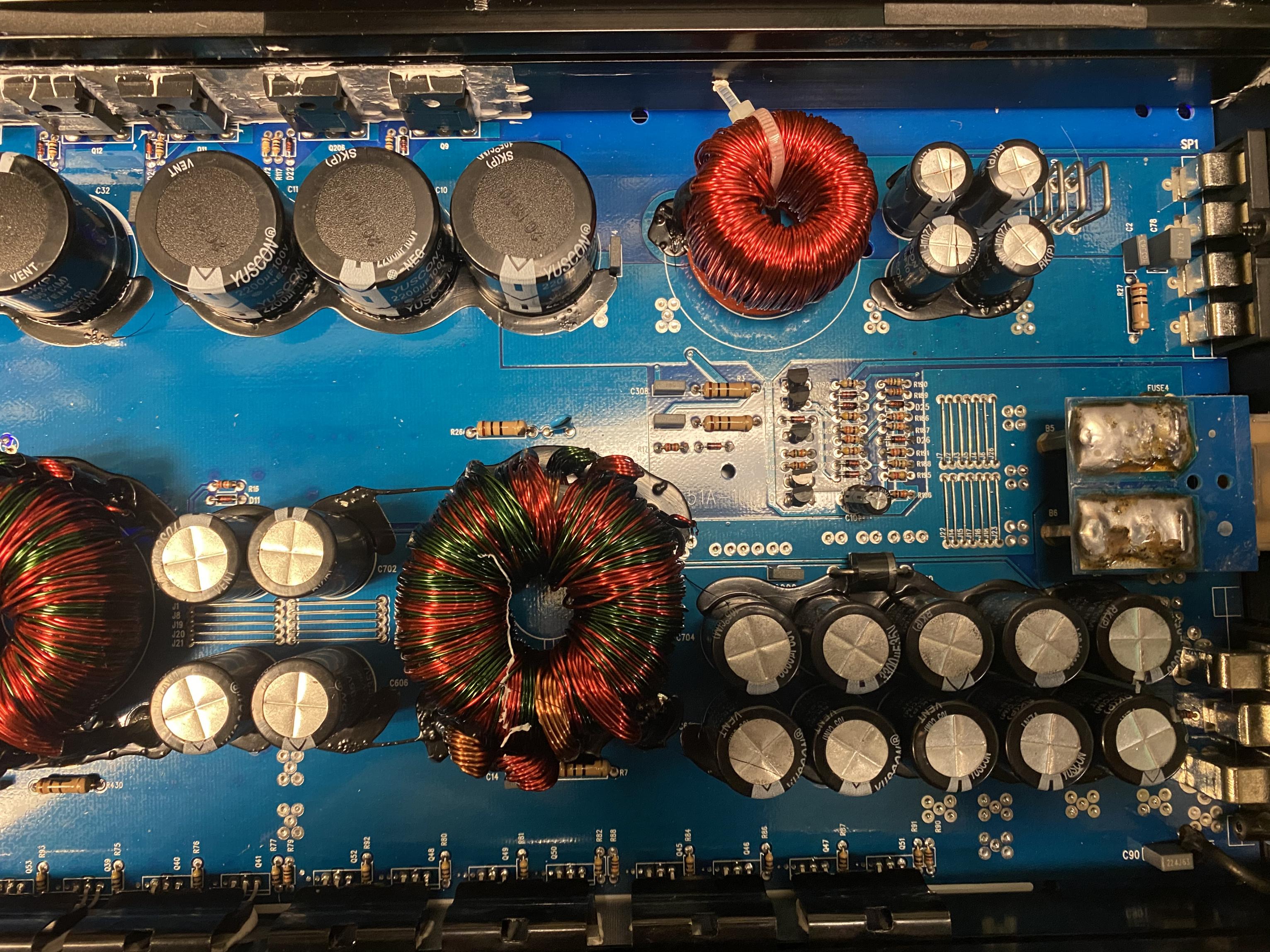

Amp powers up and produces rail and regulated voltages .
Amp has no output .
I do not get any rail to rail oscillation on the outputs .
Any ideas on where to start
Amp has no output .
Sorry forgot to add photos

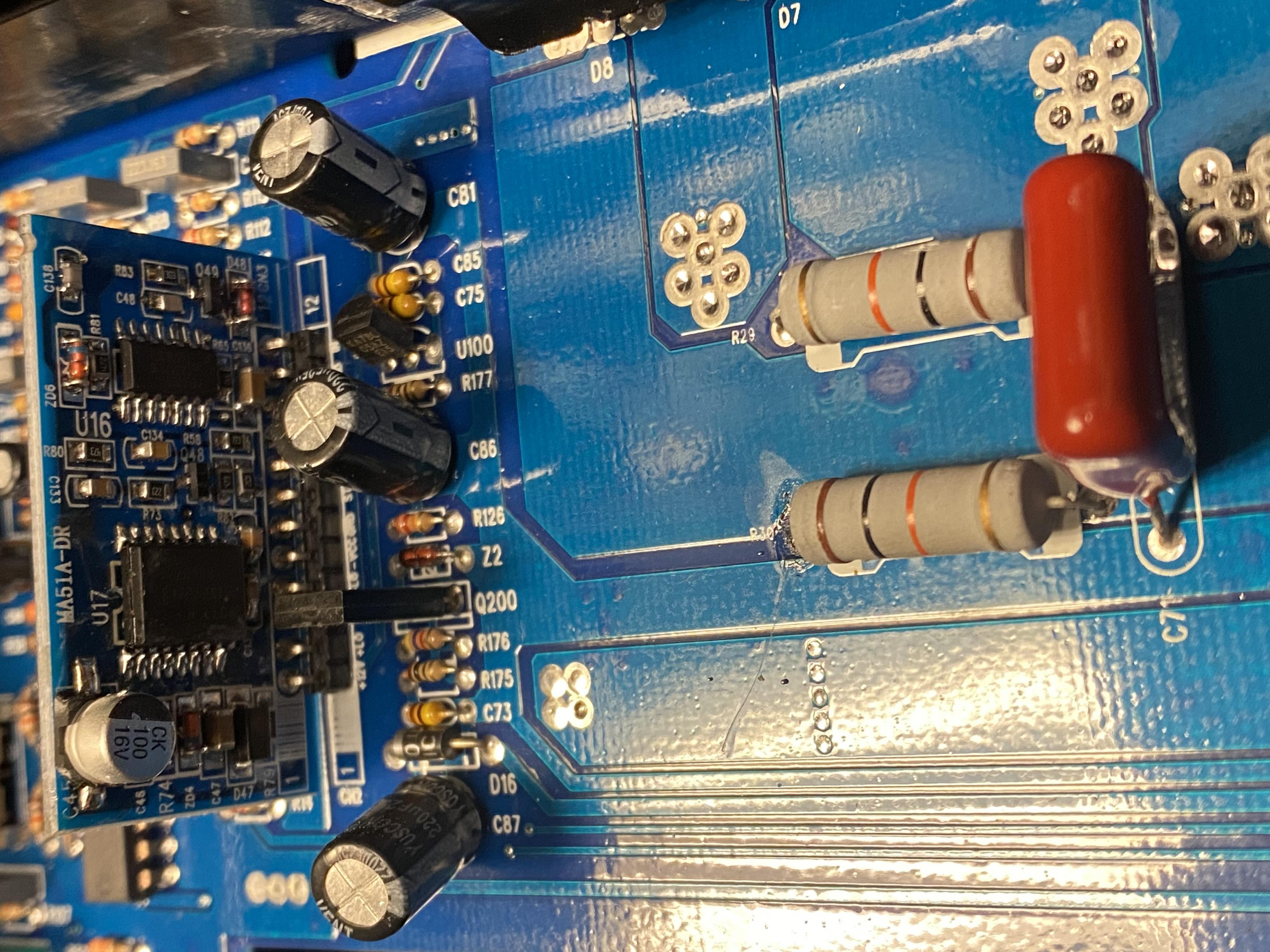

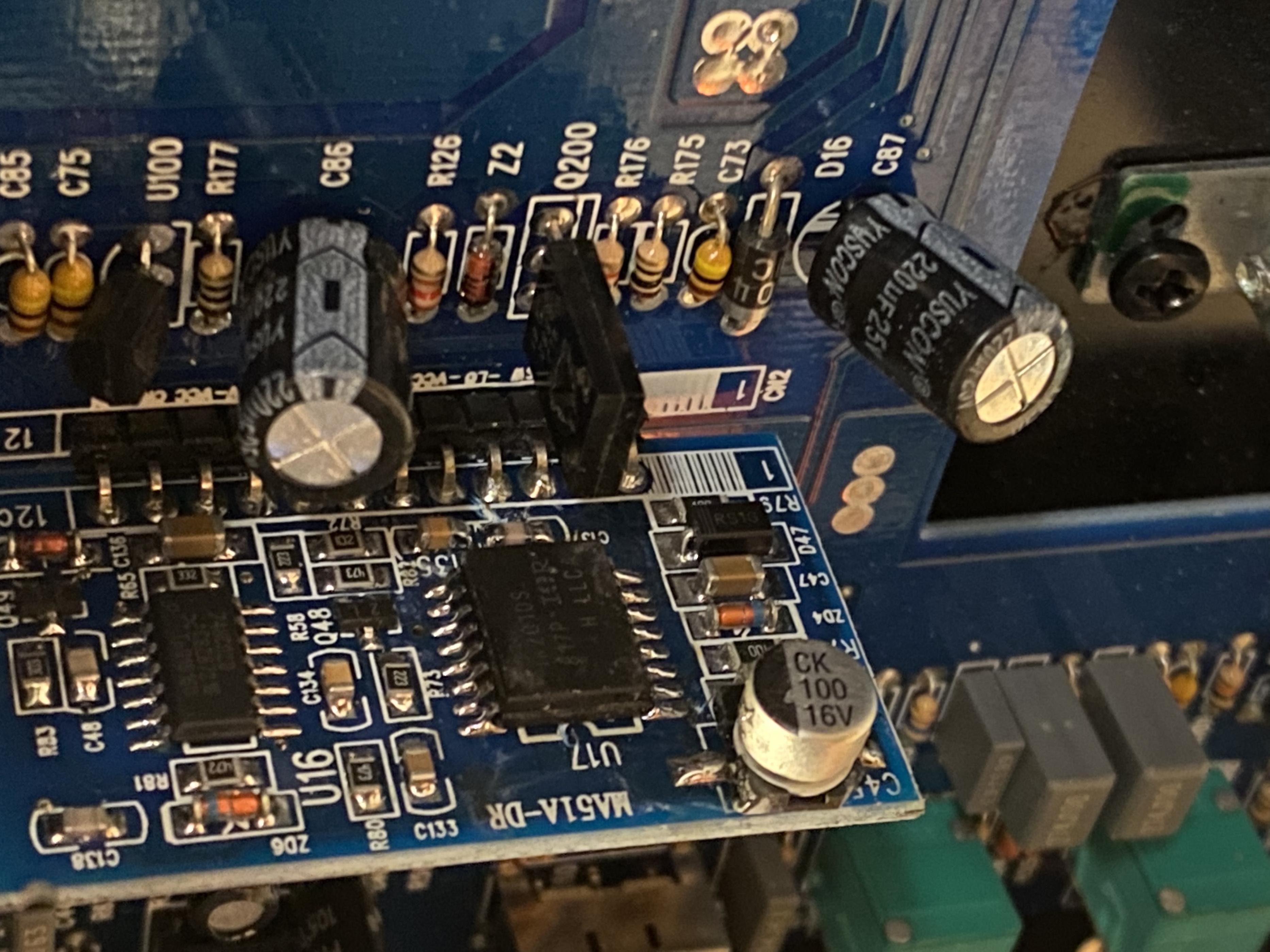

Are all of the voltages marked in front of the audio driver board present and correct?
Are there any parts on the back of that board?

This is what I get on the pins of the audio driverboard using amps ground terminal as reference.
There are no components on the back of the audio driver board

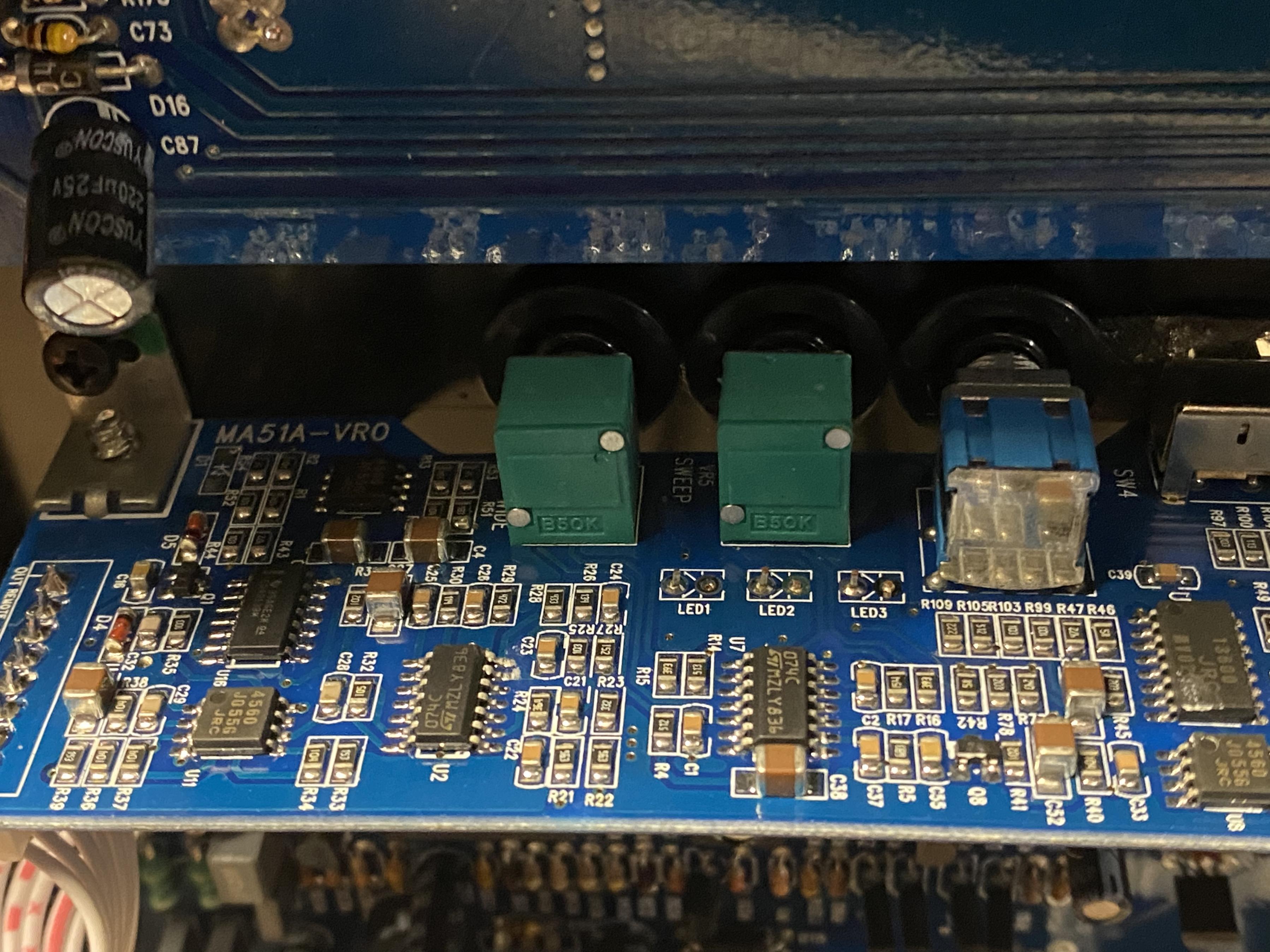

Do you see any signal on the input pin of the driver board when driving a signal into the amp?
I do not have rail to rail oscillation on the outputs .
I see a distorted square wave on the in pin of the audio board .
If I adjust the gain on the amp the square wave cleans up but still a square wave on the input pin
