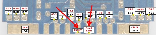

After a read on the "Basic Car Audio Amp Repair" page, I took the amplifier out of the car (the bad channel was not hooked up) and had another look at it and tested the FETs. The readings are all over the place on all 4 of them. One of them has a different number than the other three and is obviously cooked, as well. It looks like a patch job was attempted by the previous owner (I've had the amp for about 10 years now).

Sorry Perry, I was referring to the transistor with the A1479 marking and the 1 to the left and two to the right in the close-up shot (on the sub channel FEB cards) as I figured that must be at least partly responsible for my troubles as it is all blackened. After another 4 hours of reading and testing, it turns out all of these transistors on all six FEB cards seem to be fine (and the number on the transistor is correct as well). Either that or they are all damaged as they read the same across all 6 checks (transistortestpage01) in the diode check and ohms position on the multimeter. I'm doing my damnedest to take this slowly and read and reread pages of information, but it just seems to get more confusing as to what and where I should be looking. :confused:

What is the DC voltage on the two points on the defective channel?
Another possibility is all transistors are fine (despite the dark marks on the PCB---heat over along period of time). Sometimes the solder of that upright daughter PCB is cracking.
Resolder all the solder joints that holds the daughter PCB to the main PCB. I've encountered many SoundStream amps that gives DC output just because of these cracking solder, nothing is broken.
