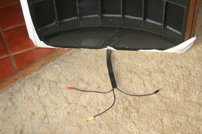

hi
i have a SOUNDLAB A3 panel which is not working. The HT supply has tested ok, and swapped over to the other speaker and found to be working ok. ? there doesn't look to be any tears or splits in the membrane. What is the audio mixer module ? I assume it on the signal side ? do you have a photograph or supplier. Is it easily unplugged or soldered. I'm in the UK
thanks
graham
Since you have confirmed that both interface units(including HV supply) are in working order, the problem must be with the panel or wiring to the panel. The description of little or no output is most likely caused by lack of bias. So, trace the wire with the yellow connector up to the diaphragm contact and check for continuity between it and the yellow connector. If you have continuity up to the diaphragm contact, then it is a problem with the conductive coating on the diaphragm.
