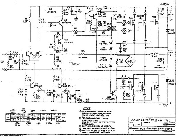

I'm still using the variac, because at about 12-15VAC I'm reading -8VDC on the output of the one channel. I have tried raising it a bit and the DC voltage on the output goes up with it.
I don't have much experience yet, but logic tells me that having several volts where I should be seeing mV is not good for the componants. When I first got the amp I plugged it directly into the wall and measured the voltage on the output. I was reading -64VDC on one channel. I haven't plugged it into the wall again, only through the variac. On the good channel I am reading about .2VDC or less.

I have repaired at least a dozen of these. they are VERY stable amps. each one i have brough up on a variac without problems. I have even had these amps running on 20V dc rails!
If you have DC offset, you most likely have bad driver transistors. these go all the time. if those test good, then start yanking mosfets as these do fail!!!
The mosfets are attached directly to the heatsinks! the heatsinks are isolated from everything. the case of the fets and the heatsinks form the main output line. this is speaker level before the output inductor.
Also, check to see that the power supply rails are near the same voltage.
You can pull out all the mosfets and tie a 1K 1/2 watt resistors on both sides of the 180 ohm resistor between the drivers to the output line. this will allow the amp to run without the output devices to a healthy level. those driver transistors are rated for 1 watt!
Without the mosfets you should be able to get a good clean trace with minimal offset.
Start checking mosfets. none will be shorted. but the gate resistance will be all over the place when compared to the others. some will be in the M ohm range those are typically good, others will be in the 100 ohm range and those are typically bad.
Also the inputs to the fets have zeners and 1n4004 diode to limit gate voltage in gross overdrive situations. make sure none of those have shorted. also the fets have 1n4004 diodes across them. make sure those havent shorted.
These are fairly simple, and very robust amps. however the solder traces leave a lot to be desired. they burn off easily.

I don't quite follow your comment here. The 180 ohm resistors are the gate resistors to dampen oscillation. Do you mean to tie the output end of these resistors to the speaker output? This added resistor would be in place of the removed MOSFET. Is this correct?
Hi Zc,
I have been hoping you would show up. I have read many of your posts about the Soundcraftsmen amps.
I bought new parts and replaced all of the 2N3440's and MM4003's. I think those are the drive transistors you refer to no?
They all had missing legs. Two of them were just laying in the chassis. Most of them only had one lead still attached. Not sure if they corroded away or burned. Looked like corrosion though. There are rust spots on the cases of the MOSFETs. This thing has had some moisture in it.
The PSU measures good. I'm thinking it is probably the MOSFETs. I pulled every componant except for the MOSFETs that looked like it lead to the output and still there was voltage on it. I will post back when I get it apart again. Should be jsut a couple of days.
