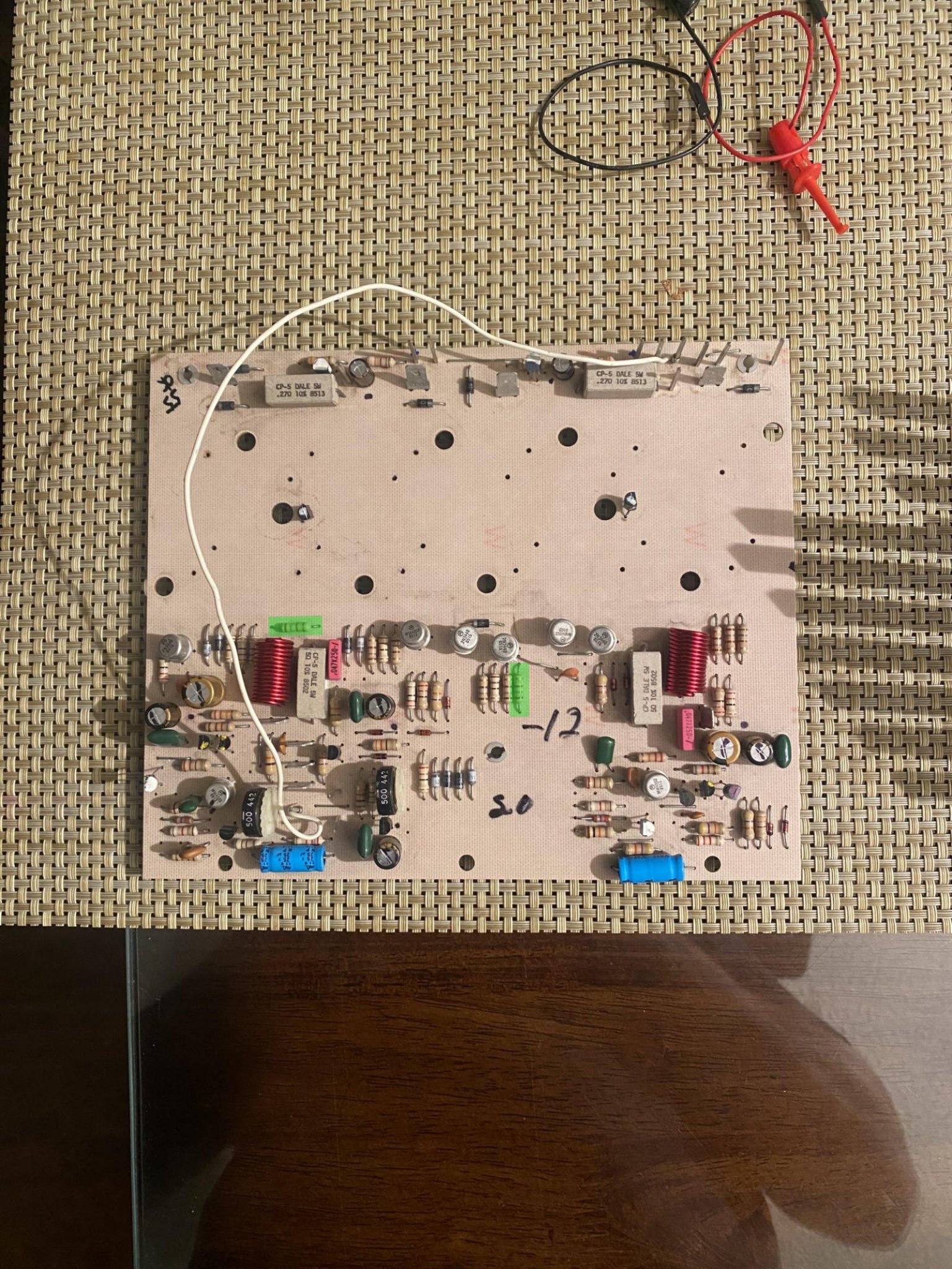

hello, i realize this is a old post but i will ask anyways. i need to adjust my bias on a pm860 ..the amp is similar to the pcr800 ..would you know by looking at the board the resistors i need to go across to check bias ...any help would be greatly appreciated.Hello,

I was almost going to give up on this amp,thanks so much! Should i replace all the j50/j135 outputs ,or can i just search for one. I used a peak atlas dca55 to test and there is only 1 j50 with bad part reading. I also dont know what the 2 transistors are in the middle under the heatsinks. the part # looks like pn2907 ?
You can replace one if that's all you want to do. Otherwise the only option is Exicon 10P20 and 10N20 transistors from Profusion. Those 2n2907 are for temperature sensing, they rarely go bad. You can check the junctions. And the temp sensing voltages are checked at the op-amp after it's running.
Yeah, I dont know if i want to replace all the mosfets .My concern is matching of course. I was trying to adjust the bias when i touched something that caused the output to go bad. I suspected that it was those 2 resistors to adjust bias but i was not sure.... the 400mv is that with the fan in place? i was thinking a 100mv per output device since this has a total of 6 Mosfets per channel ...i also had a audible hum through my speakers with nothing connected to the inputs. ....turned out to be 1 of the input jacks since i converted from Phono plugs. ...I have 2 of these amps 1 is up and running.......thanks for your help Frank.
Actually you can only check one junction of the 2n2907's because they are shorted from base to collector on the board. They are just there for the junction voltage. The voltage drops as they heat up and that voltage is compared to the temp setting voltage to determine fan operation and PCR limiting.
It doesn't matter if the fan is in place, I usually have it out of the way. The .4V on that resistor is the difference in voltage between the output transistor gates from positive to negative devices. The more voltage; the more current the transistors idle at. Amperage could be roughly calculated by measuring across the current sensing resistor and multiplying the amperage x3, but I don't feel the need to do that other than in special diagnostic cases. I set bias to the factory .4V and watch the power usage on a watt meter that the amp is plugged in to. 20-25W is the typical range for these amps to run without the fan hooked up. The fan adds another 20W on low speed idle. If something is wrong with the idle power, I notice it right away and start looking.Yeah, I dont know if i want to replace all the mosfets .My concern is matching of course. I was trying to adjust the bias when i touched something that caused the output to go bad. I suspected that it was those 2 resistors to adjust bias but i was not sure.... the 400mv is that with the fan in place? i was thinking a 100mv per output device since this has a total of 6 Mosfets per channel ...i also had a audible hum through my speakers with nothing connected to the inputs. ....turned out to be 1 of the input jacks since i converted from Phono plugs. ...I have 2 of these amps 1 is up and running.......thanks for your help Frank.
