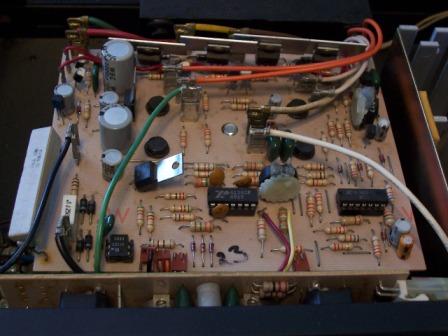

Attached should be a compressed picture of the top of the board. Hopefully it is clear. The orignal picture shows the brown spots clearly.

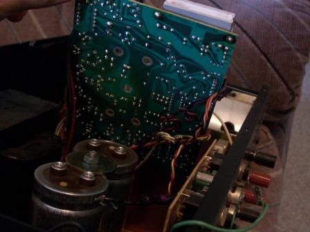

The burn marks (light brown squiggly lines) I saw were on the top side of the board. I'll try to take some pictures of what I see and post them. I don't recall the caps being vented, but I'll look again and try and take a picture of those too.

Squiggly lines sounds like maybe at some time a wire over heated.

The only brown spots I can see on the PCB are at the leads of the big power resistor on the lower left. That is normal for this amp, that resistor runs hot! Is that it, or did I miss some other spot?
The caps look fine, but they are still the primary suspect. Sometimes parts fail without any noticable physical damage.

To fix the loud buzz and tripping the breaker, I took my amp to Diversified Audio in Tampa, Florida and they found it was a single SCR in the power supply. They advised no reason to replace anything else.
