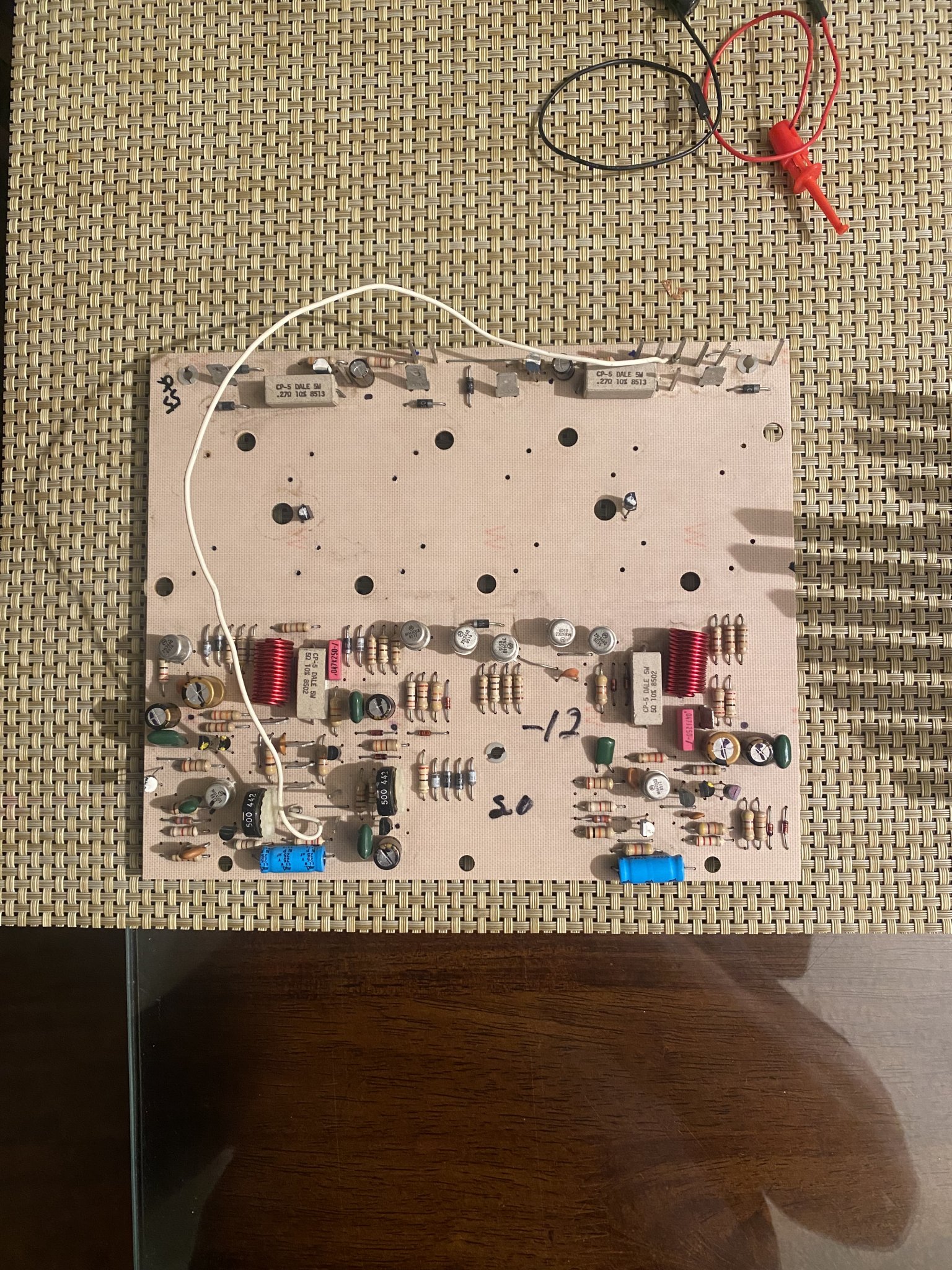

hello, Zero cool: i know this is an old post but i will ask any ways. do you know what resistors on the board to measure to check bias?
