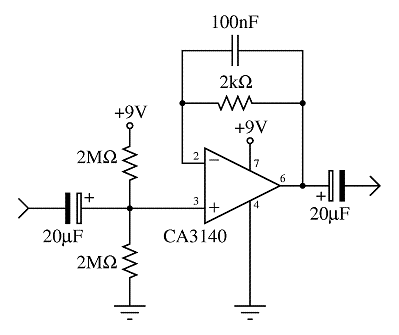

I read about this years ago, but never gave it much thought until the other day... when my old scope died.
http://www.geocities.com/~uwezi/electronics/projects/soundcard_osci.html
the circuit is extremely simple and could be built for free (or under a buck or two)...
Just curious if anyone has tried it? I plan on maybe throwing one together tonight and seeing what happens. Hmmmm....

Hi elementx,
I would do some work towards input protection for the op amp. Also, some range switching wouldn't hurt either.

Here's another one, looks a little more official...

http://xoscope.sourceforge.net/hardware/hardware.html

Hi elementx,
It would have been cheaper to go to Radio Shack and buy a pair if you are paying for shipping. TL072 is improved for noise.
