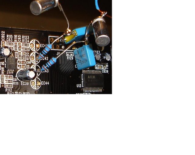

Hi Jens,
Go to Bluegears web page and use the Linux driver of the b-inspirer.
It should work just fine.
If possible do not use the Toslink and do the mods that I described. Unless you have a Dac that is above $3000 I doubt you will be able to match the sound of the modded card.

The EMU 0404 USB would be your best bet.
I have the onboard PCI version and the sound is already terrific.
The USB version has much more mod potential than just cap or opamp swapping. It should already be better having been freed from being inside a noisy PC environment. Things can be improved further if you build a quieter PSU.
And yes, the 0404 is fitted with the redoubtable AKM4396 converter.
