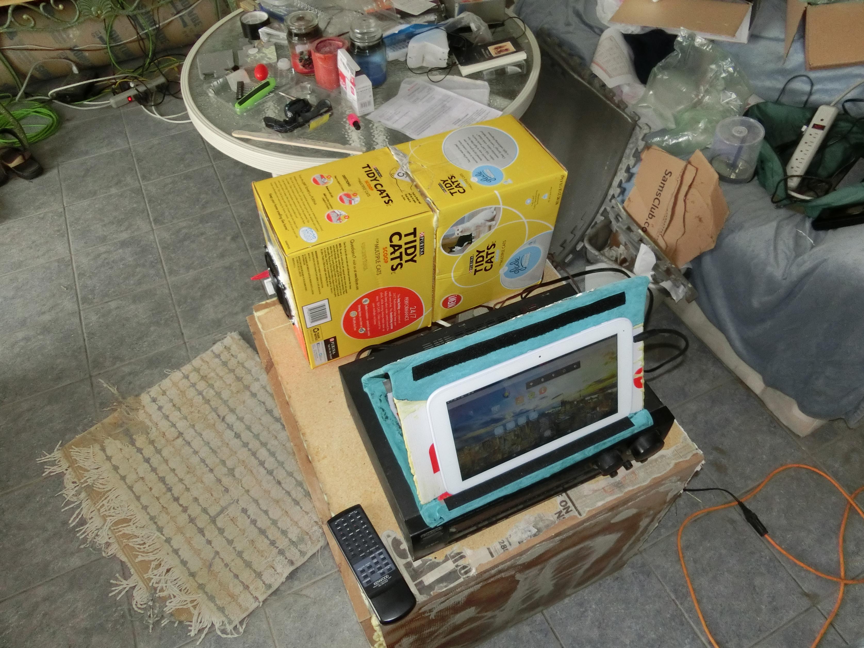

Have assembled a working prototype now. Instead of frying the driver with the NU3000 I am using a Kenwood KR-V7070 receiver a neighbor donated to me (and it works, after some power on crackles.) Here is a photo of my current test rig. The husk of the former Frankenclosure sub serves as a table, awaiting a bonfire opportunity. The source is an Android tablet. Patrick, thanks for the ambiophonics links. I've found an Android app called Neutron (music player) that has built-in Ambiophonics. 5-day free trial.
With the set-up as pictured, there is an audible difference with the Ambiophonics engaged. Right now I am listening to just plain stereo and the sound is quite spacious. Listening to older tunes (Jazz, 1960s) helps...more separation in the 4 and 8 track recorder days, I believe.
It's amazing what can be done with crappy auto speakers (3-way Scosche 5.25" from the local Sprawl-Mart) and trash! As noted above (?) the enclosures are a pair of kitty litter boxes, stuffed with rags. I don't know if it makes any improvement, but I've improvised some very low-effort "lenses" out of respectively, the cap of a super glue container (tweeter) and plastic bottle lid found in drawer (mid), each cut in half.
Now, the only problem is how to camouflage this appalling creation 🙂

My kitty litter speaker is now painted blue. Meanwhile, the Kenwood receiver after working ok for an hour or so (both pre and post my cleaning) decided to pitch a fit (noise in one channel) so it was set out with the trash this morning 🙂
