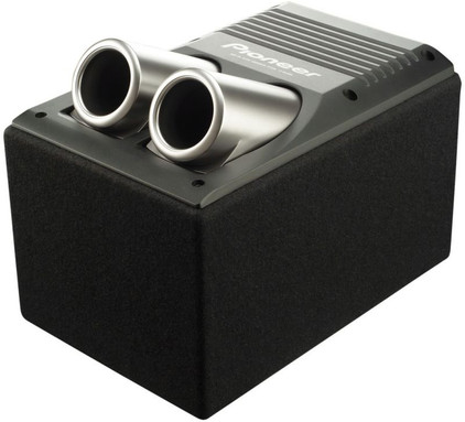

Seeing the trike I had to think of the pioneer TS-wx206a
I have 2 of those as well and they have great output for their size and weight. The box is made of mdf 🙁. If you rebuild is with ply (okoume) you can save some weight.
If you combine it with a classD car headunit with bridged front/back outputs for the tops, you have a nice setup as well.

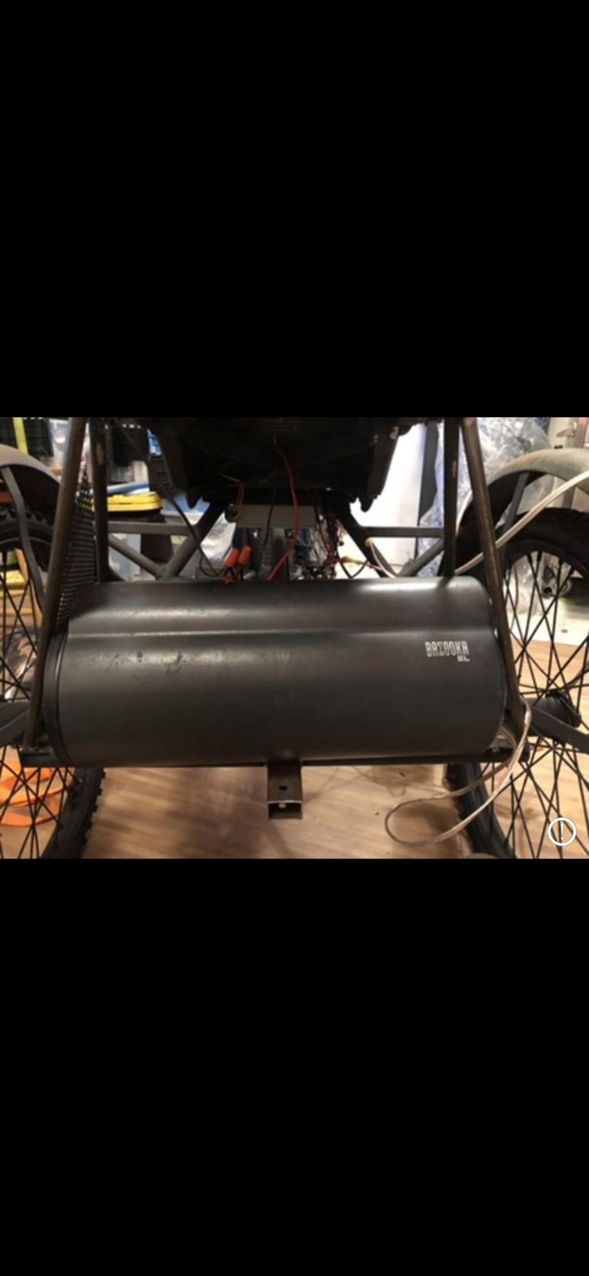

I ordered a tpa3116 amplifier and am thinking of going with a 100w 6” bazooka bass tube in the back with two 4” speakers on the handkebars. Was thinking it would be nice if they were marine grade so wanted to go with the Polk audio DB401 or possibly the DB402. Does anyone know if one is better than the other? I know the DB402 is newer but the d401s have amazing reviews. Let me know what you think? Should be done with the build by the end of next week.
Which 3116 amp?
These are some nice coaxials.
DB401 Frequency Response 85 - 22000 Hz + Sensitivity 91dB
DB402 Frequency Response 60 - 22000 Hz + Sensitivity 90dB
The DB402 go a bit lower and are a bit less loud, so I would go for the 401's. Prices seem $90-140 If you can get the 402 a lot cheaper then the 401's I would get those as they are similar.
This sub? Amazon.com: Bazooka BTA6100 BT Series 6-Inch 100-Watt Amplified Tube Subwoofer: Car Electronics (if you add links you will get more replies)
" 85 Hz Low-Pass Filter (18 Db/Octave) " is to low, you will cross around 150-200hz and $175 is a lot of money for what you get.
" Patented tube enclosure design is optimized for "corner loading," for maximum bass performance" you won't have corner loading and the "Sensitivity 103 Db" is an in car/fantasy spec.
A 6" sub woofer is probably not going to keep up with them. An 8" has double the surfice area and a 10" more then 3 times. Sealed car subs can live in 10 and 20 liter boxes; a flat model box should fit fine.
You want to have an 2 ohm sub woofer for the 3116 amp which makes the search a bit harder. 2x8" in a 20 liter box would be a nice option.

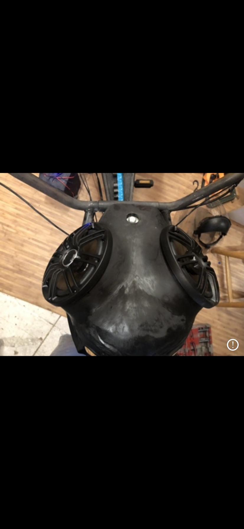

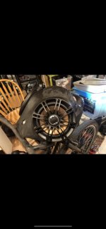

Ended up finishing the trike it turned out awesome! Will post some pics and possibly a video of it lets me. Went with 2 6” Polk audio all weather speakers mounted in the head of the jaguar and a 100w bazooka tube in the back.
