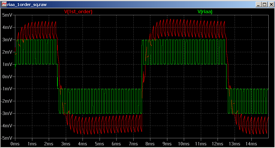

...except for some major deviations in the midrange. You need EQ, just a different one than for a velocity-sensitive transducer.
simple Bode asymptote aproximations: ~ 1:4 zero-pole "flat spot" is going to give ~ 12 dB difference from the expected pure 1st order slope of a uncorrected strain gage cart response
could be viewed as 12 dB mid/high cut or +/- 6 dB at low/high vs 1 kHz matched level
but in any case "celarly audible" by just about anyone in ABX comparison with a accurate RIAA played on the same system - pink noise anyone?
it could be excused on not doing level matched comparisons, by just walking into a demo room with unknown speakers/room frequency response - still I would be suprized that anyone with truely trained ears - even many "lesser trained" ears than recording/mastering engineers, techs wouldn't pick up on that much error even if they weren't sure where to place the blame
red single pole response - I assume even though strain gages give DC response any audio system won't like it so I kept the 50 Hz corner
green RIAA, the curves level matched at 1 KHz
looks like 38 degrees, 3.2 uS phase, time errors - where our hearing is pretty sensitive too
I pre-emphasized 2mV, 100 Hz + 1 mV, 5 KHz square waves and put them thru the 1st order 50 Hz LP and full RIAA eq
with 1 KHz matched EQ levels for minimum FR error you can see red single pole "uncorrected strain gage cart" response is wrong at both low and high frequencies
but what's +/- 6 dB error as long as there's a good audophile story attached?

JCX, thanks for the information.
So, you're saying the strain gauge is just a first order slope. It looks like that first order slope closely matches the first part of the RIAA curve. I mean if you had the low frequency amplitude set the same, you'd have the first pole.
Did you measure a strain gauge cart? It wasn't clear to me from you post.
Anyway, if the response is like that, all one has to do is get rid of the first pole on a standard phono preamp, and the rest is taken care of.
I'd be interested in doing this. I've got my Pearl phono preamp boards stuffed and working, so perhaps I could mod the filter and get rid of the first pole in a way that doesn't affect the rest of the filter response.
I mean if that really is the response of the strain gauge.

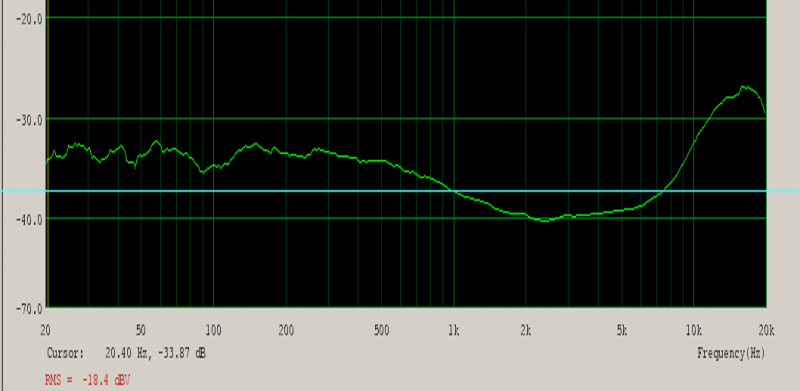

In my MPP thread you find enough information to build a strain gauge phono amp based on the Panasonic models. I have also published FRD curves there. Without any correction you get a presence dip and a rise in the upper treble so without any EQ is plays but does not sound optimum. I have shown a way to build an equalizer.

In my thread you find the response of the Panasonic.

Now, equalization is another thing... The cartrige doesn't have a flat response. It has a slight peak around 100-300Hz of about +2dB, and then a pronounced valley of about -3dB from 2KHz-6KHz (i'm recalling this from my head, don't take these figures as exact). But the real thing is that response from 15KHz-20KHz goes up to the sky (+6dB).
I find that the most important thing is to correct the highs using a standard low pass filter with cutoff at 10 to 13KHz (to suit your taste). The 2KHz-6KHz valley is better not to correct since IMHO it gives a 'pleasing' sound.
I do have an EQ circuit on the Vinylengine thread that in theory would give a flat response, but i haven't tested it due to lack of time. However, i think that the most important thing is to filter those extreme highs.
