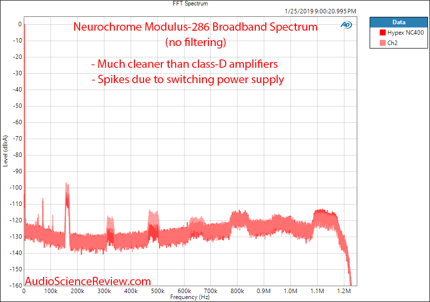

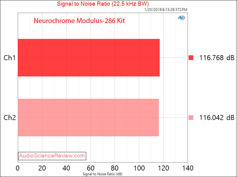

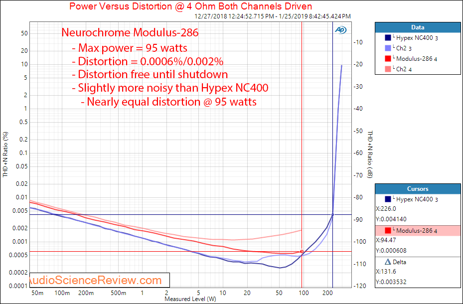

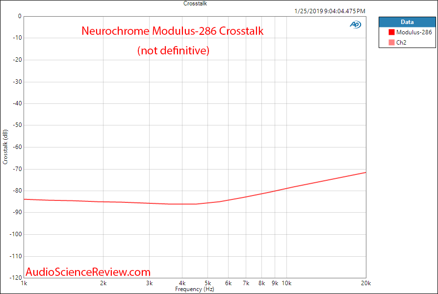

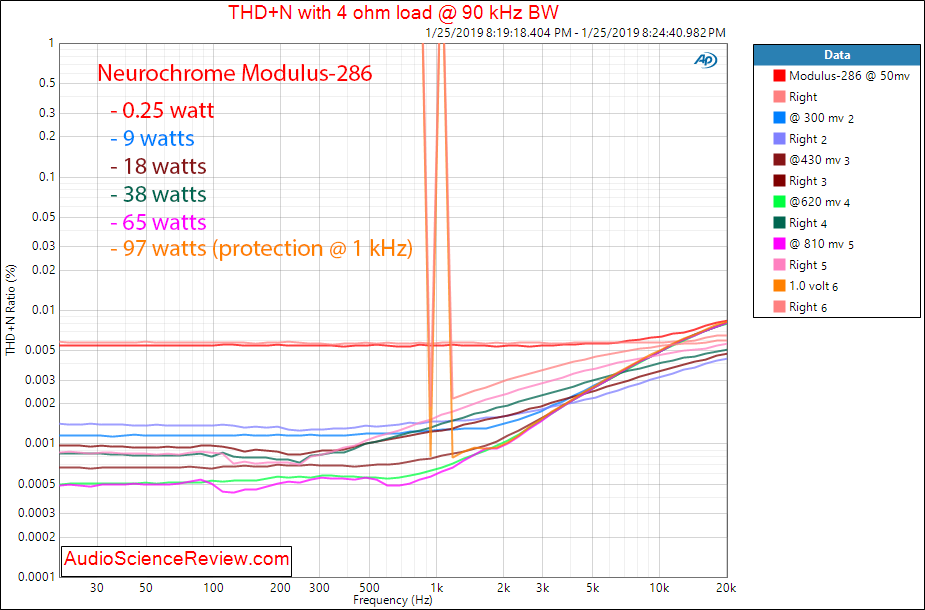

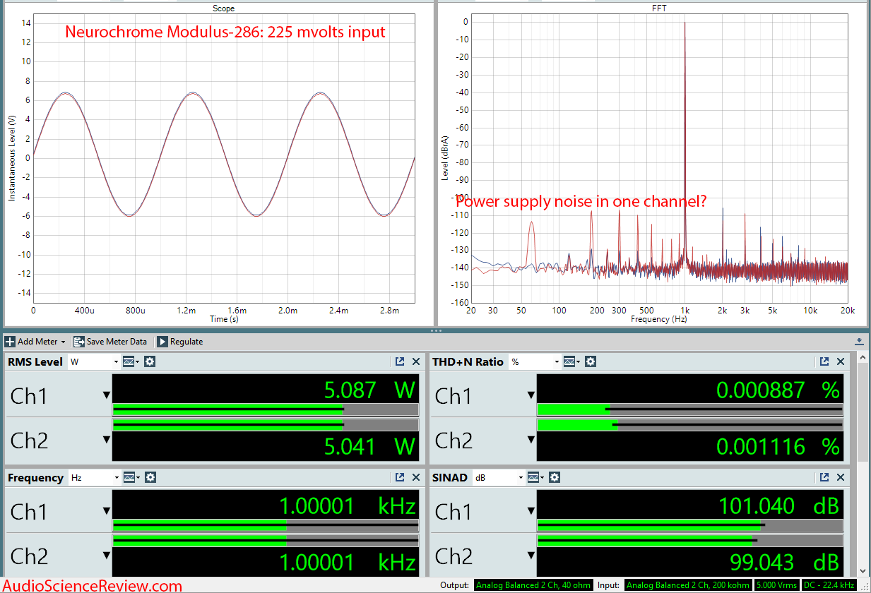

Peufeu aside it looks like no one is interested on performing a few measurements to understand if there is a relation between the measurements and the perceived sound.
Measurements of the Neurochrome Modulus-286 amplifier from the other site, are they useful to understand the sound quality of the amp (since it just implements the LM3886)?
