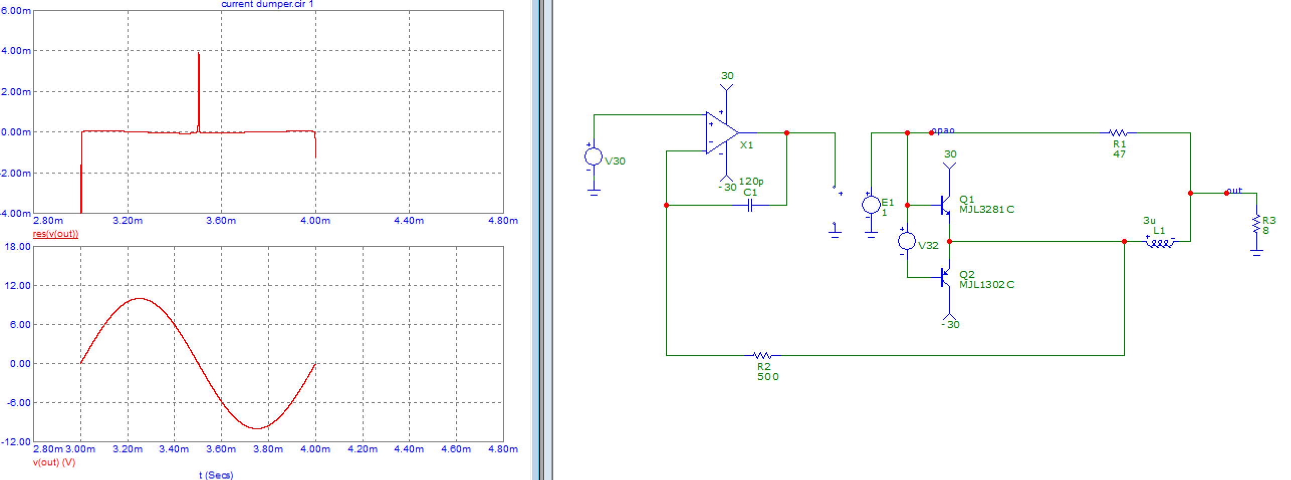

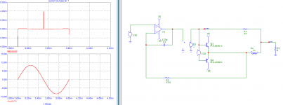

This is not the QUAD current dumping stage. It misses the balanced bridge feedback which was the whole point and makes all the difference!
How can a bridge be balanced when one of its impedances is in series with the highly variable and non linear output impedance of an unbiased class B output stage? OK, I added the bridge, with a 0 distortion NE5532 model, an ideal driving stage, and the bridge components from the article.

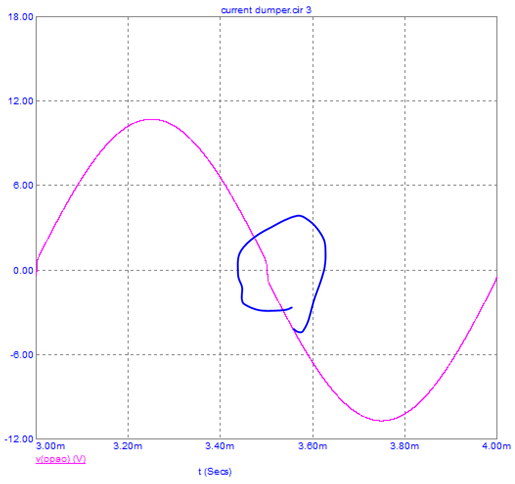

I don't like the look of this distortion residual, it is... spikey.
Messing with the bridge increases the crossover spike, so it does work. But the output signal of the opamp has to slew a lot when the transistors are off, so...

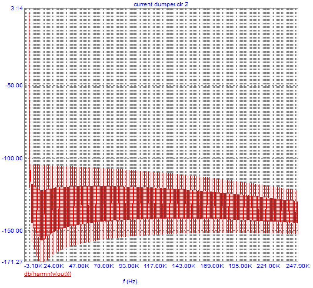

"smooth harmonics rolloff"
- "all the harmonics are below 100dB!"
- "yeah but there's a gorillion of them!"
The irony is, that with a bit of bias on the transistors (50mA), then the balanced bridge really works. First, because the opamp doesn't get a kick in the slew rate at each crossover, and second because the output impedance of the power stage varies less, so the bridge stays more balanced. The residual is tiny. They had an idea that would work really well with a bit of bias, and they used no bias at all.
So, thank you for recommending that, I had disregarded it because of the predictably bad results with a class-B output stage, so I had not thought about using it with a class-AB output stage...
