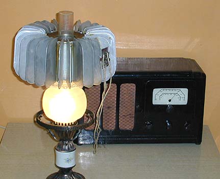

Here is picture of TGK-3 generator powering radio. Yes, they were used in some Siberian villages were electricity was not available yet (deep forests called Taiga), hundreds of kilometers from towns. I believe today they would be regarded as very audiophiley, no AC ripples at all.
Hi jcx,
Thank you! I can always count on you to liberate a smile from me.
BTW, I got me some of those radios. Some even older than that.
