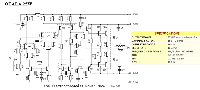

we have the Otala/Lohstroh amp.
Which circuit you are referring to here? The one with asymmetrical supply rail? If so, does it sound different than the symmetrical supply rail version?
Jay, I am unaware of any assymetrically fed amps, by Otala or anybody else.The one I refer to is the original Otala/Lohstroh amp as publushed in 1973 in IEEE.
AES, perhaps, for Otala Lohstroh amp.
The asymmetrical one was like a printed image, so maybe AES, I think it is the original. What I have built is I think an implementation by Electrocompaniet. But I can't check it right now.
There was such a circuit by Nico Visch. It was the subject of the thread entitled " Class B w/o crossover distortion (1975)" on this site.
Ooops I mixed things up. The Electrocompaniet version is the one with asymmetrical supply rail (+/-26 for output, +19/-44 for front end).
