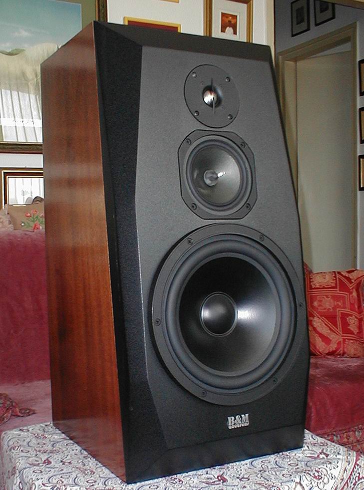

My apologies to all, this is a message to Richard Marsh, and is related to my loudspeakers as a fairly rare piece of audio gear which both measures well and sounds even better.
In brief, it measured as reasonably efficient at 92 dB/2.83V/1 m, with an anechoic response of 36...22,000 Hz +/-3 dB, but 40...18,000 Hz +1, -1.5 dB, which is as good as, or better than studio tape decks. L to R box differences within 0.5 dB. It can be biamped or triamped, party or fully active, as you choose and as you shuffle around some internal wiring made by pure silver litz wiring from Neotech. The internal passive x-over is point to point soldered, however in three distinct groups, so you can have a powered woofer but passive mid and treble, almost any combination possible. With suitable amplification, it will deliver up to 114 dB SPL at 1 m.
It main attraction though is the fact that it is the easiest load I know of in dynamic speakers. Nominal impedance is 8 Ohms, maximum is 12 Ohms, minimum is 6.5 Ohms, worst case phase shift is -25 degrees. Literally ANY amp will be able to deliver its best with it, but at its own risk. If anything is not right, the speaker will show it up, and vice versa, if the amp is good, the speaker will come on song. Frank would probably kill for it, I reckon. Even tight wad Nige would dish out the dough for it, I guarantee it. 😀
I am proud of it, indeed, it was my design brief, and was developed by a Friend of mine, Mirko Bevenja, who did 95% of the development wotk regarding cabinet and drivers, and we developed the crossover together. It took us 6 months to get the crossover just right, very tedious work, but in the end, it was well worth it. I am pleased to say that a friend from Belgium actually drove down to hear it and left with two pairs. Another friend from Italy also bought one and is very happy with it. Only 7 pairs were made before the company dissolved, a great pity.
In reality, they are my pivot point in the sense that I value whatever according to how it sounds over them. This is in line with Frank's views, I think, to build a system which is not there, it simply disappears and leaves you with the music. I can do it in three ways:
1. Let my Karan Acoustics KA-i180 integrated amp do all the work. It's rated at 180/256W into 8/4 Ohms. I was told by people that this combination sounded like the best of SETs without any of tube amplification problems and all the virtues of solid state;
2. Use Luxman C-03 preamp, fully refreshed with new caps, drive my Marantz 170 DC power amp, also fully refreshed and somewhat beefed up with main caps which are much larger than originaly (1 dual 12,000 uF cap originally, now 2 discrete 22,000 uF caps), or
3. Use my Citation 24 amp (2x100W/8) for the mid and treble and my Harman/Kardon PA 2400 power amp (2x170W/8) for the bass in a biamping scheme. Aletrnatively, use my Marantz 170 DC ampf for the bass and my Marantz 1152 DC integrated amp in power amp mode also for biamping. Both have very low global NFB of just 12 dB. The last H/K amp, 6550 integrated, could also be used in power amp mode for either triamping, or, using an active XO, for going active.
Either way, nothing in my entire audio life has given me as much pleasure as those speakers.
