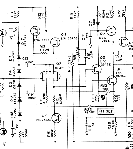

For example, say you have an input stage in a cascode configuration. The usual commercial approach is to use a resistor divider, with a small value cap (100...220 nF), or a zener diode, to obtain the required lower voltage.
A resistor divider will be fine if your basic PSU lines are very stable. In that respect, a zener is a better solution, because it doesn't care what your PSU lines are like so long as they are above the zener voltage.
Now, I wonder what would happen if a simple zener diode was replaced by a zener assisted capacitor multiplier? Throw in a say 220uF cap after it, and you have a truly bullet proof CCS. In measurements, that doesn NOT show up, but I wonder if it would result in a slightly cleaner and clearer sound?

This is the most sophisticated cascode circuit I have seen. The goal is to keep hte input cap of the fets constant with signal. Any cascode that is fixed and not following the signal will not address that issue. I get the same results using depletion mode mosfets in a much simpler circuit.

But here the PSU lines are almost certainly higher than the FETs will take, so cascoding them is a necessity, either that or some subregulation for just the FET.
My feeling, and I could be wrong, that things have shifted to a point here where if you don't use cascodes, it won't really work, so to speak. Sort of doomed to forever stay Mid Fi at best. Nobody actually said that, but it's a feeling I get and can't esacpe.
Yet, one of the best integrated amps I heve ever heard, admittedly after some tweaking, is my own Harman/Kardon 6550, and all it has is a simple differential pair made up of BJTs. It hardly needs anything fancy, given that the gain of that diff pair is set at just 4.4:1, the lowest point their onw documents state should not be made any lower. At that kind of ultra low gain, those BJTs are behaving more like FETs, seems to me.
Obviously, the rest of the circuit is also very well done, nobody gets such results from the input stage only.
