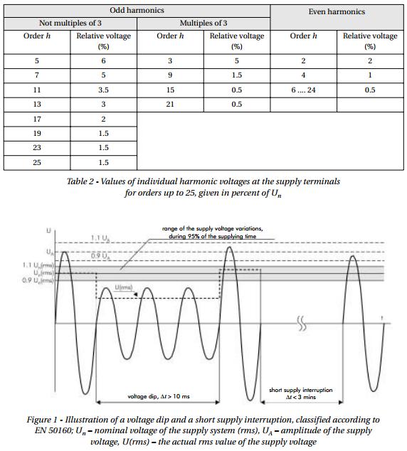

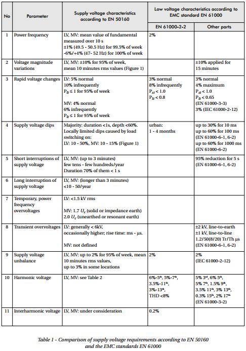

Very interesting . When at my old company we asked for voltages seen arround the world. Not the internet, what our technical people knew first hand. Approximately 180 to 280 V in the 220/230 areas. I could well beleive the frequency would also swing vastly when dropping to 180. The point the people made was local arrangements sort it out and circuit breakers keep things safe if over current. Better to have some elctricity than none. The most suprising was Austrailia sometimes hitting 270V. I wonder with that one if a myth ? My friend Martin said so 30 years ago and an engineer/hi fi dealer said so recently. At my now company I use 180 to 280 when I can. A friend in the USA says 130V is not uncommon.

When 230V was adopted across Europe, stated tolerance was +5%, -10% (207V-242V) for backward compatibility
No.
The European Harmonised voltage range is 216Vac to 253Vac
i.e. 230Vac +10% ~-6%
Prior to harmonisation, the UK used 240Vac +-6% i.e. 225.6Vac to 254.4Vac
I think that many assumed the old UK standard was 226 to 254 and I have seen many documents stating these values.
