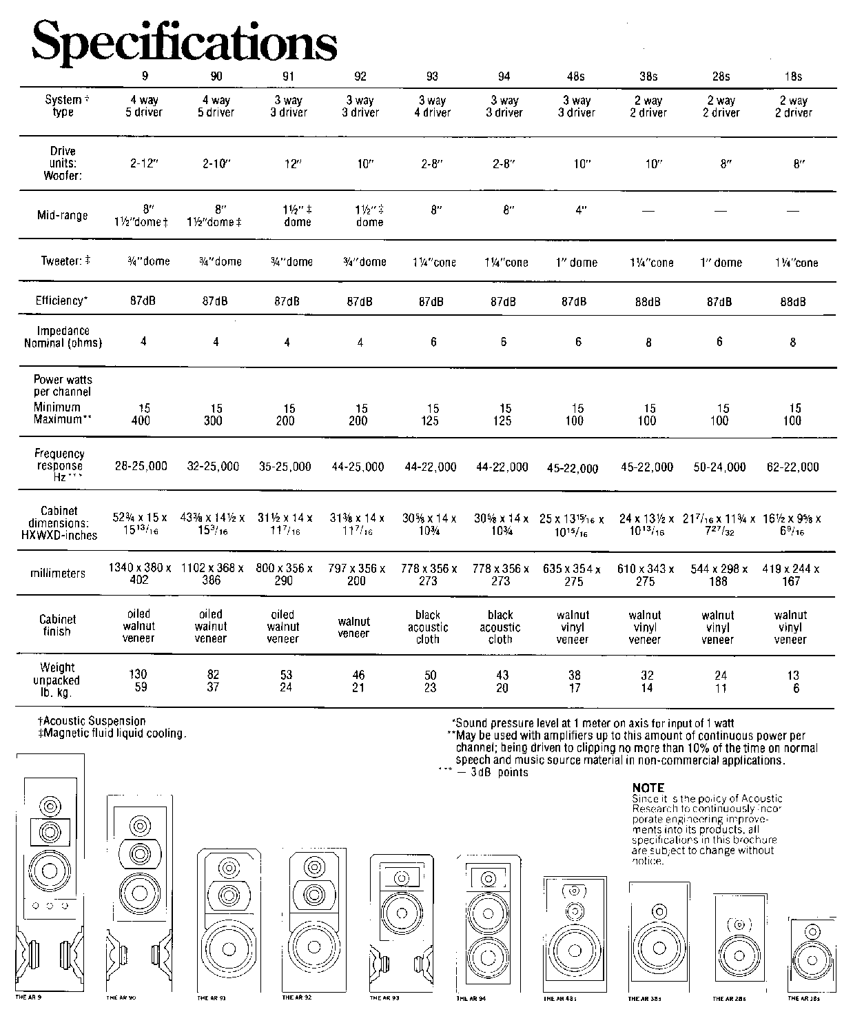

I've been listening to my AR94 speakers and wondering at myself. I realize now that it was really never about them, but about the rest of the system. They are far more revelaing than I remember them from 12 year ago, but then my entire system has changed, and most notably my power amp. At the same time, I am delighted not only with that, but just as much with the fact that I seem to have hit the nail on the head with the upgrading of the power amp. Completely recaped, but the two main capacitors were changed from a dual concentric 2*12,000 uF/56V by Elna to separate milk cans by BC Components (ex Philips) of 2*22,000 uF/63V.
Normally, just recaping an amp with fresh 'lytics will produce a positive difference, after all, that dual concentric measured at 7,200 uF, less tha half of its nominal value, and now it has +86% of nominal value. Forunately, that's all it took, everything else on the original PDU was so overrated this was no problem. And I have no better test bench for it than the AR94, which are nominally 87 dB SPL efficient, but do have nasty crossover characteristics. They kill most standard fare pretty dead if you turn the volume up. Now, the Marantz doesn't seem to even notice it.
At the same time, while delighted that the 94s are better than I thought they were, I also realize that they are no match for my own speakers, which have much better low and high ends. Different concepts (AR is acoustic suspension mine are bass reflex), which are comparable in the midrande only, where the ARs still do a great job. But their bass lines are not as deep as with my speakers, and lack its bass authority and pure gravitas, taken the bass line "size", when bass lines seem to have a greater size, sounding big and well controlled, whereas the ARs come across as veryclean and well controlled, but appear to be more "shallow", with much less authority.
