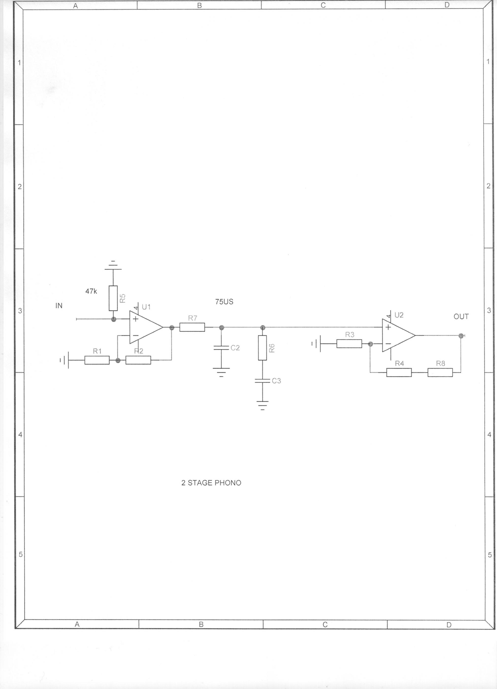

For completeness, I will put up the alternative to 2 stage design, and is sometimes used in hi end designs, including SY's, Walt Jungs, and even me (on occasion).
The problem with this design is the input stage gain needed to keep the high frequencies from falling into the noise region, ultimately, because we can use only 30dB or so of input gain.
SY's approach is optimum for tubes. For solid state, we have to work with lower impedances for the EQ, and the following stage very quiet, in order to keep the high frequency signal out of the noise floor.
It can be done with solid state, but it is not as easy as the passive-active EQ approach used in the Vendetta, JC-3 or the Constellation. Entirely open loop operation, however, is probably best. That is what Charles Hansen and I strive for, and SY seems to do well with it as well.
