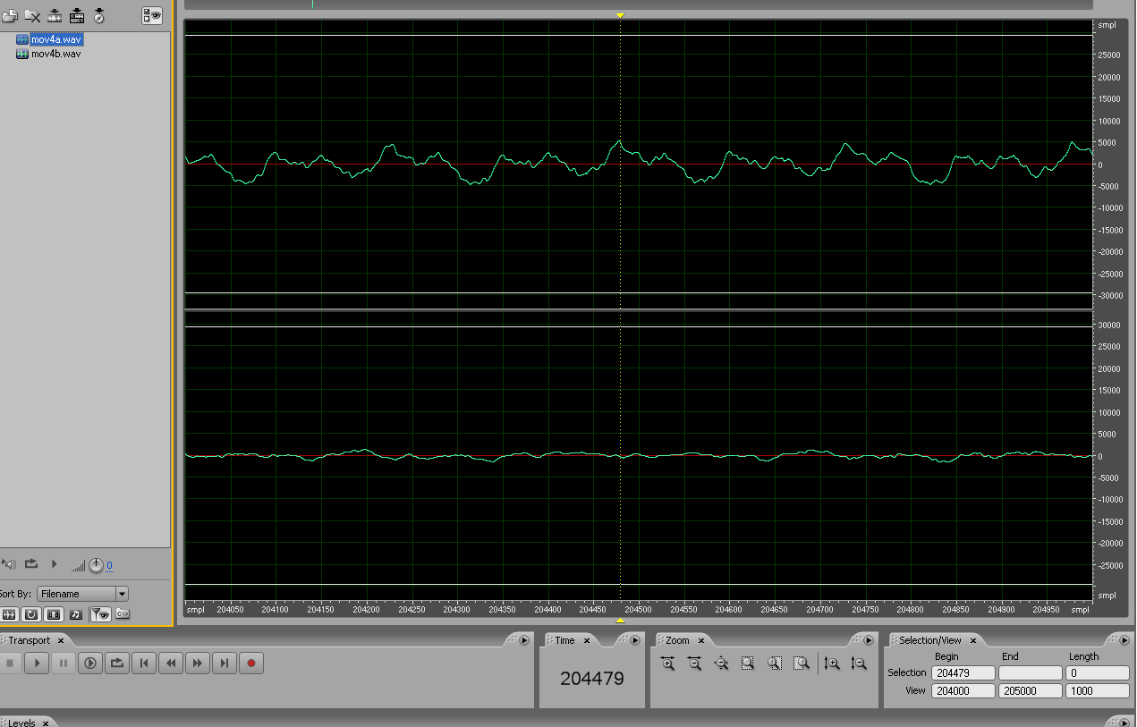

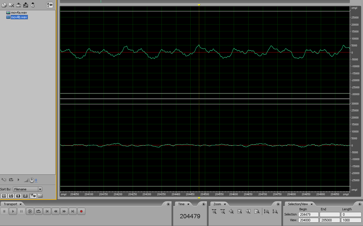

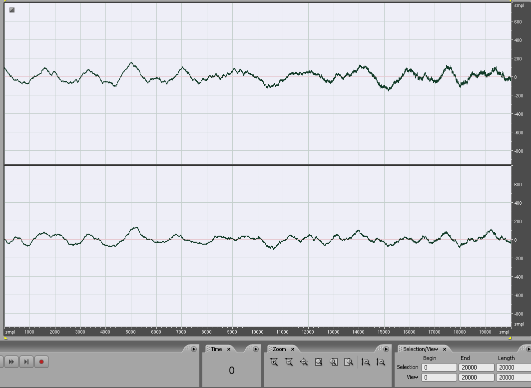

BTW, this is the difference in that two files:
https://www.dropbox.com/s/cj7834fxl4jyjjo/mov4b-mov4a.wav?dl=0

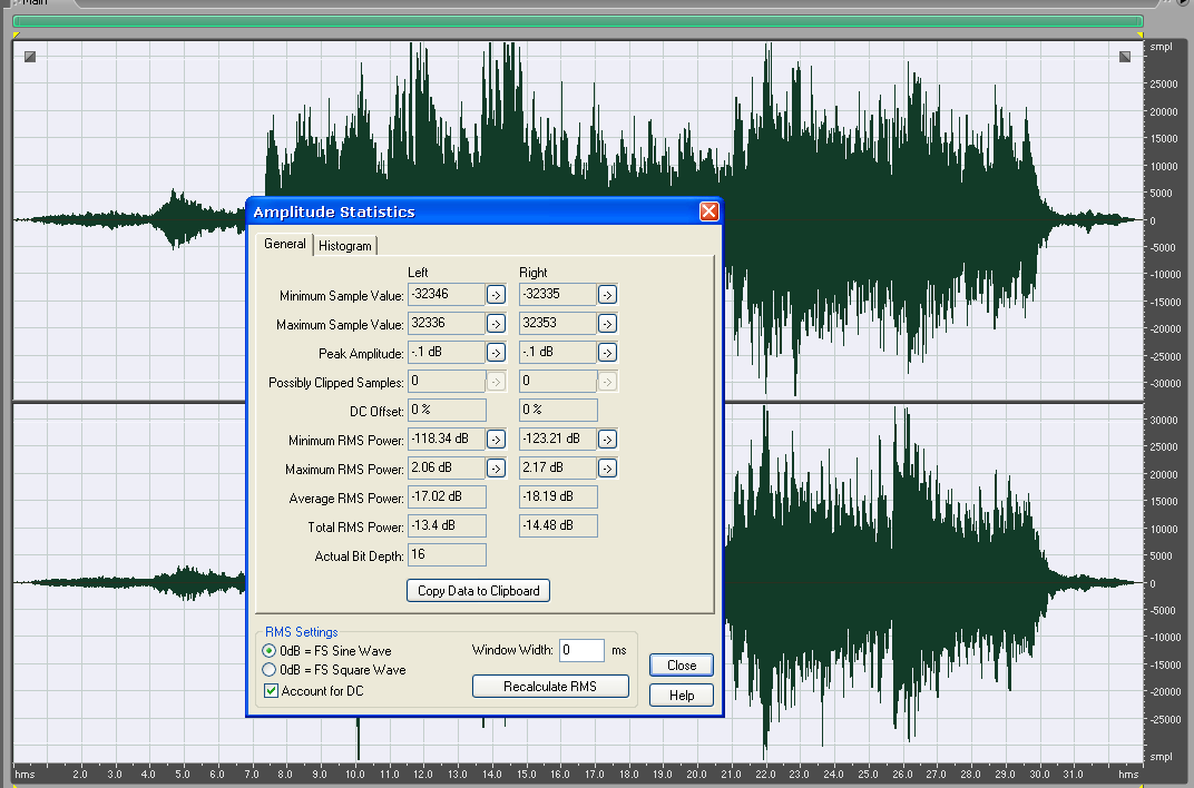

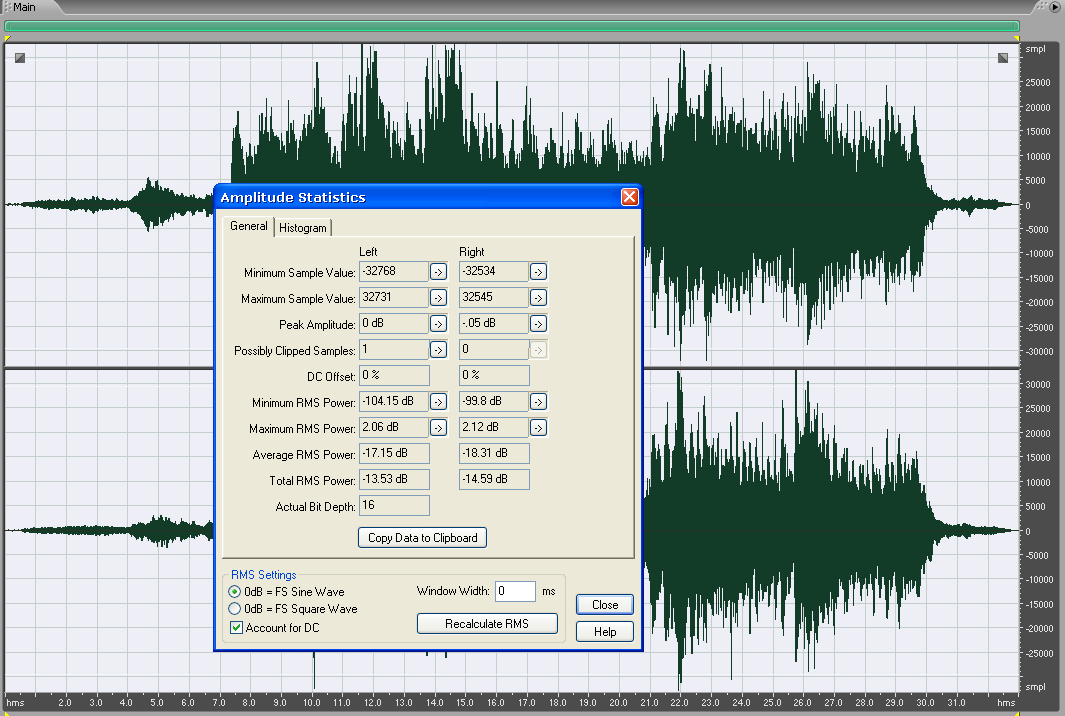

mov4a and mov4b amplitude statistics, no amplitude manipulation has been used.
"Matched" I meant that there is no special difference in volume setting, sorry for possible confusion. Amplitude statistics should make it clear rather than words. Words are a subject of nit picking.

One criticism on the files you posted: The start and endpoints must be exactly the same, this is not the case. Most codecs add silence before and after the sound file. This can cause a false positive.
Not sure if I understand you. To me, the files start point is the same. How do you define or find the "start point"?
Wow, now I can see it, mov4b is 500 samples longer (1455500 x 1455000). Sorry, my mistake when I filled in the file length, I have overlooked one "5" character.
