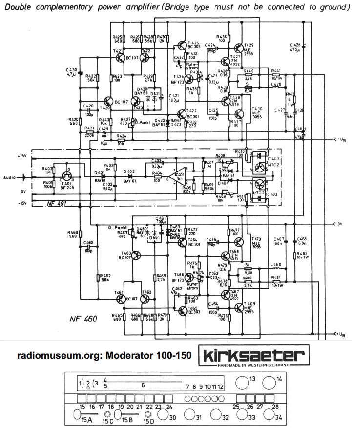

Did I ever fire you for being so bent towards 2N3055?
You wouldn't dare. 😀
These were inside of one of your favorites
George
The irony GOBS of feedback, op-amp + CFP. 😛
