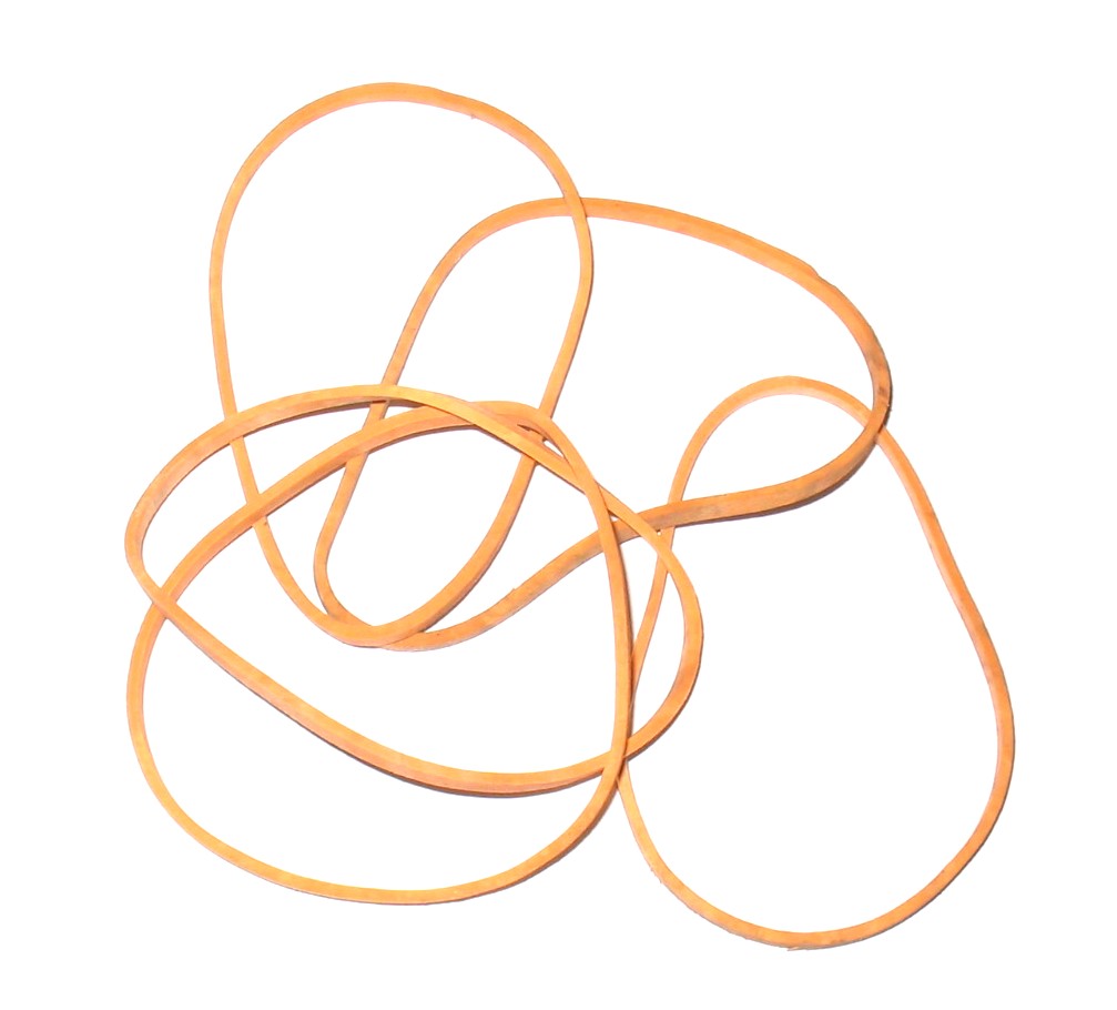

Sort of- it's actually crosslinking (causing embrittlement)
Thanks.
A few rubber bands left on the table or the bench have given me a clue about the amount of UV exposure from the lighting fixtures.
If you try it, don’t be surprised if the rubber bands become hard and brittle after a month or two (keep a few from the same batch wrapped in black paper or plastic as the ‘control’)
