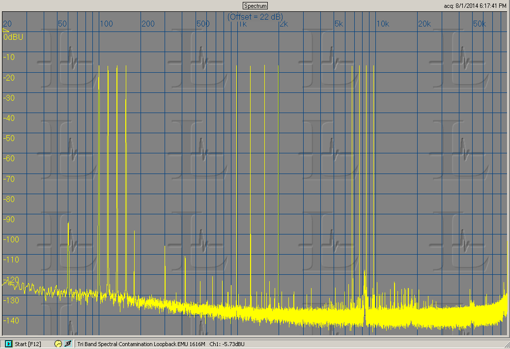

Never the less any tool of this type should be able to highlight issues with noise obscuring low level details in the presence of high level signals. I have used a test signal that has 12 tones that are not harmonically or IM related. In the digital realm (DA:AD) I can usually get down to the noise floor between tones. Add an transducer (headphone) and lose about 30-40 dB. Speakers are worse. The loopback test is below. The only open question is whether there is a change from running to stop to running which would be most likely a thermal effect. I can provide a wave file of this as well.

The difficult part is that speakers get lots of obvious things wrong, gives DiffMaker a nightmare - but IME they can get the critical things right, what matters subjectively. Which is part of the challenge, sorting that out ...Speakers are worse. The loopback test is below. The only open question is whether there is a change from running to stop to running which would be most likely a thermal effect. I can provide a wave file of this as well.
