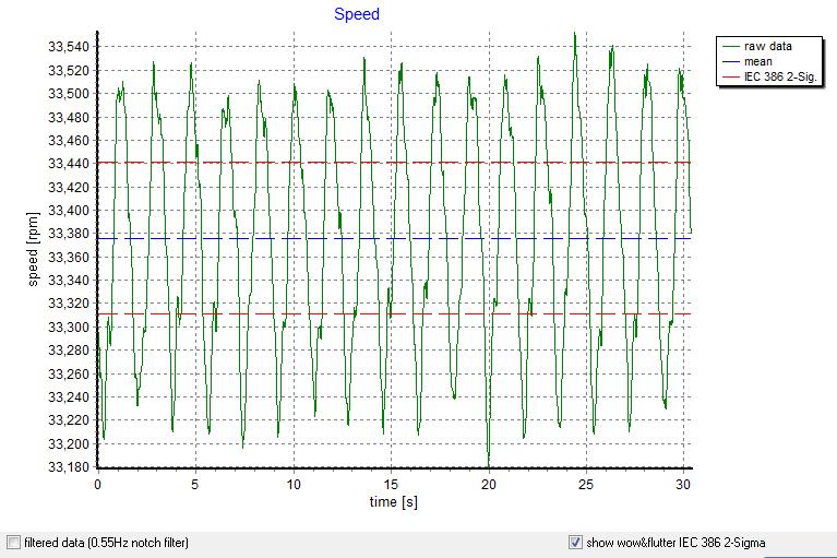

Even though my turntable wow & flutter isn't exactly stellar, see attachment...
Jan

Jan, do you actually HEAR the wow&flutter, as is, or indirectly?
If not, than what do you care?
No I don't hear it. But you know me, I want to know 😎
BTW If you look at the wow frequency in that graph it should be obvious where it comes from....
Jan
Jan
It's OK to measure it just so you know, but it would be silly to worry about something you do not hear as such, or implicitly.
I have an old Dual CS 604, direct drive, from 1977 or 1978, I forget which, which is quoted at something like 0.05% or some such. It has never failed me, and it probably never will, and in return, I will refresh it this automn.
It has never sounded great, I'd say very good for its price class, but I must add I am using Ortofon cartridges, which are finnicky about capacitance and need 400-440 pF total to be truly linear. In my day, I measured the whole setup and have written down the capacitance present at the RCA output jacks. This helps me adkist the preamp phono RIAA input capacitance so that the total is what is required.
Although Orotofon says 47k input impedance, by trial and error I have discovered that the best sound comes with a 59k impedance and 400 pF. Hence, once given its optimum, I get better sound than most sonly because I took some time to get it all right.
I suspect you did something like that as well. So, sit back, let the music play ans SMILE! 😀

Wow and flutter is easily heard to me on piano recordings. On suspension tables, worn or loose springs will exaggerate this ....
Yes, I'm sure that you could easily hear this on piano, especially long, sustained notes. Is this large variation due to a bad belt or pulley?
