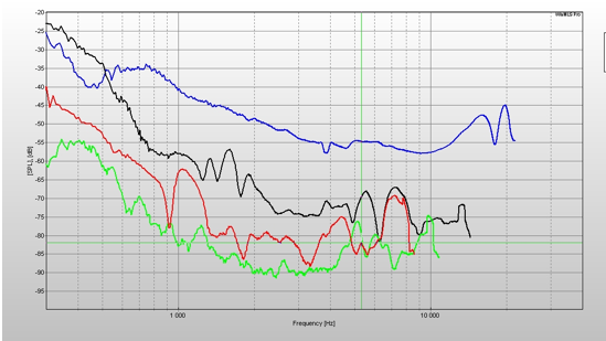

To give you an example here are the measurements of a modern tweeter i use in a commercial product.
It is not even a ribbon but a metal dome.
Distortion is measured somewhat over 90dB in 1Meter.
It is composed mainly from second harmonic that amounts to under -55dB over 3kHz.
that is 0.18%.
Over 10khz it goes a bit up but i doubt that many of us can hear up to 20kHz.
All higher harmonics are so low that they are hard to measure. I would say this tweeter is transparent so why correct it ?
