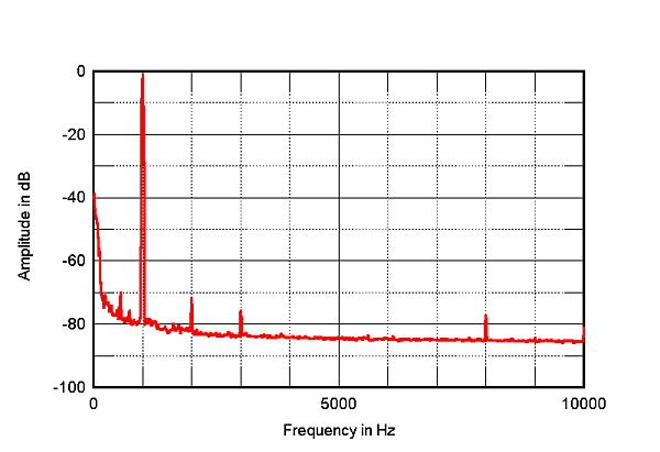

We should put to rest the very old mark of 1% as being typical of todays speakers. Distortion well under 1% has been available for decades. If one is to hear at or below .1% it would be with a speaker of .1 or much less --- to be able to notice changes to tones caused by added harmonics.
Example :
Use a speaker like this to train your hearing acuity.
THx-RNmarsh
Example :
THx-RNmarsh

Thank you for posting that Mister Marsh.
I suspected there's quite a few speakers with much lower than 1% THD.
The IEM's I linked to earlier, after looking a bit further I think they may actually be the lowest THD IEM's on his site.
