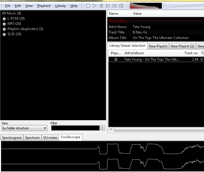

square-waves in normal pop music
I took a picture of a square-wave type shape in normal music. Uploaded as an attachment.
Note that the square-wave here is a rhythmic beat, however as soon as she starts singing with the beat later it looks a lot less like a square-wave shape, even if it still is.
The song example here is Tata Young - El Niño
I usually see unnatural shapes in synthetic music like trance, dark electro, chiptune, etc.

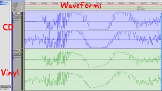

This is very heavily clipped music. That's why it looks like a square wave, it runs into the max level limit, probably in the ADC. This must sound horrible!
See the attached similar example.
Jan
