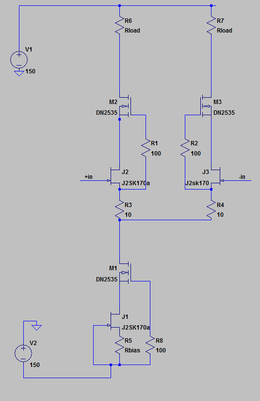

Nigel, you have to take notice of a few things about jfets:
First, they can get VERY leaky with high voltage on them, that is close to the voltage spec limit of the particular device chosen.
Second, they don't dissipate much power across them, because they are invariably in TO-92 packages or something equivalent in power dissipation.
Three, putting random Idss jfets together as a pair will not really work well, even with a servo, so be prepared to match them AT LEAST for Idss which is really easy by the way.

John is right about the Jfets. Here is what I have been doing for some time. The depletion mode mosfets are good for 350V and used this way will reduce the input capacitance and cap modulation a lot. 150V supply should be enough for any amplifier driving dynamic drivers except perhaps motors. The parts are not real cheap but not expensive for what they do. Mouser stocks the Supertex parts. The TO92 is around $.60 in singles. You could use the jfets to referenced. There was no noise spec but the Rds on suggests they may be low noise. Use a trimmer for the two 10 Ohm resistors to dial out the offset.

Hello Nigel,On another thread I am trying to design the ultimate low cost 1920's style amp. I have with very little regard as to practicality looked at EF184 TV pentode driving Russian 6A7S double power triode (a bargain and indirectly heated at 6.3VAC). The interesting thing is this seems not to have occurred to anyone. It's 2A3 and 6SN7 and forget it. The valve world is very tight thinking ...

10 Ohm degeneration resistors in your schematic looks a bit too low, Demian. I sort of expected to see something more like 33-47 Ohms.
Or do you see them as merely improving the transistor matching?
Its for offset trim. Actually I use a 10 Ohm 20 turn pot with 5 ohms from each end to the wiper. Any larger and you start compromising noise performance. You can calculate how much voltage you need from the worst case offset between the fets. If the fets are too far apart in matching (Idss) then they won't cancel distortion properly either but if they are close enough it should work well. In the sim I got 20 dB of gain flat to almost 1 MHz. It has a corner of about 4 KHz with 1 Meg in series with the input, or around 50 pF equivalent capacitance. Those seem similar to the actual circuits I have built.

Thanks John. Good to be told in the best practical way . I am so lazy and always hope for miracles. I get them sometimes.
By a very hard route of deciding DVV I think your cascode is the best. It ticks all the boxes. I take the RF problems to be important. My amp is bipolar and I uses 2K2 series input, 33K and 47pF input RF avoidance.

Picking up on what John said I think RF filtering is important if rejecting JFET's. My favourite bipolar transistors are 2SA920 or 2SA1085 for input pair . At present I use 2K2 into the input with 33K and 47pF to ground. Could I do better with a small air-cored inductor in addition to 2K2? Douglas Self says these input resistors are a NoNo. I think not? Rather upsetting to say J FET not the answer. Looking at op amps it seemed a walk in the park. Not if I have to make them cascodes. Far better to make a very low noise bipolar happier at VHF.
I have always assumed an ideal re for the long tail pair to be 50R per device ( 500 uA each) . If I need more current I use external resistors. Is this too simplistic to say 50R about right? The point being there will be a noise trade off and that is not to be ignored.

My favorite BJTs for the input are 2SC2240/2SA970.
Regarding the input filter, Nige I think you would do better to consider my favorite option, which is 2K2 with 270 pF to the ground, cutoff frequency a nick above 200 kHz.
So long as your amp is able to internally (i.e. without that filter) do something like 400 or 500 kHz, after which you limit that to 200 kHz, since it's a first order filter, its phase shift is small and high, therefore the effect at 20 kHz is minimal, and it completely knocks out even the AM band. Obviously, your chances of ever having any TIM are also greatly reduced, as the amp will always be faster than the fastest signal at the input.
Remembereing and supporting what Demian said about input FETs, if biased at 4.5-5 mA per device, they can be really linear to 800 kHz and above, so they too are saved any emeberassment of oscillating with some rogue signal at a very high frequency.

Everything here that looks wrong I did by choice. The input air cored chokes are to avoid the need for JFET's . I will try the notorious NE5534 with these. I have a hunch it will work. Could be it will make it sound as good as it measures.
This circuit is a road map and not an encyclopedia. Forgive the blobs, drew this in 2004 when I first had Smart Draw. Has been redrawn recently, kept 70% of the 2004 drawing.
