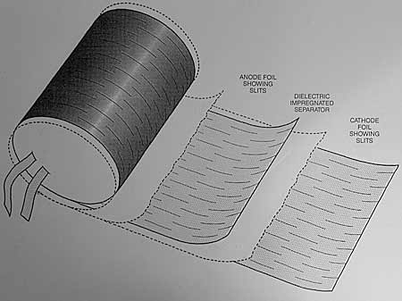

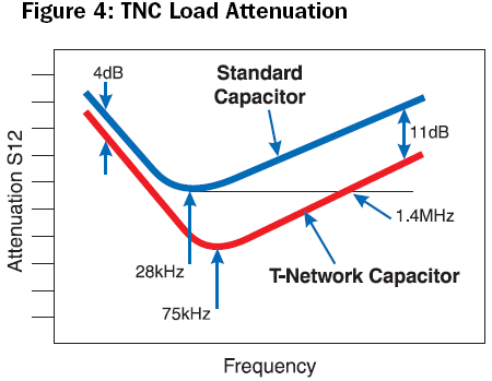

Lot's of claims about these....DNM Products - Capacitors (overview)
''In tests under load, the 4TTN capacitor's ability to attenuate
is 11dB better than a two terminal capacitor and this extra
performance is maintained up to extremely high frequencies''
Has anybody tried photoflash capacitors as local decoupling...I believe they exhibit very low series inductance.
Indeed, standard electros won't work for flash tube application.
![DNM-4TTN10000U63Vmed.jpg DNM-4TTN10000U63Vmed.jpg](https://www.diyaudio.com/community/data/attachments/402/402628-f1cd1307fadaa50cbdbf091e054885e4.jpg)
![DNM-slitfoilnewth.jpg DNM-slitfoilnewth.jpg](https://www.diyaudio.com/community/data/attachments/402/402632-8733625b609d670d77bbb24999a71829.jpg)
![DNM-capgraph.gif DNM-capgraph.gif](https://www.diyaudio.com/community/data/attachments/402/402635-098c0750c6672d0b65dcba9b666ade7e.jpg)
They're fine if the aim is to attenuate incoming noise (say mains ripple). That's the easy part and can be done with series L or R without any fancy caps. But they're no better than normal caps for reducing load induced ripple on the supply (which is a much harder nut to crack).
