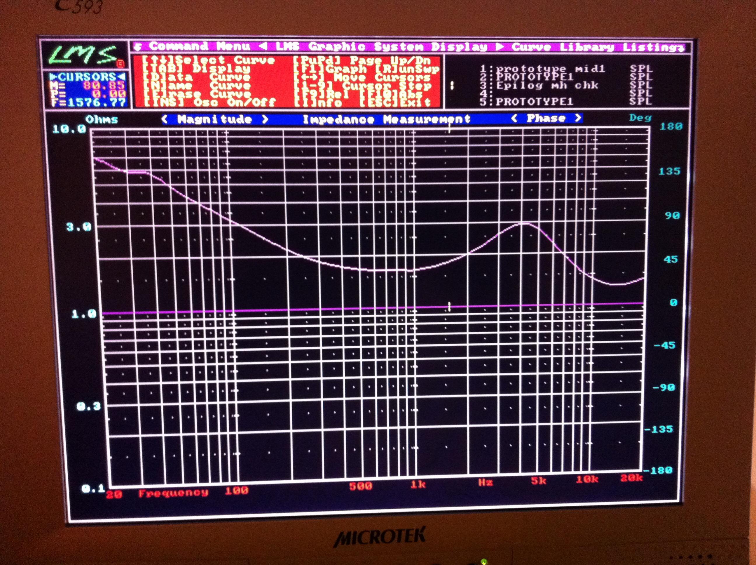

Sensitivity and efficiency changes for ur baby amp ...🙂
