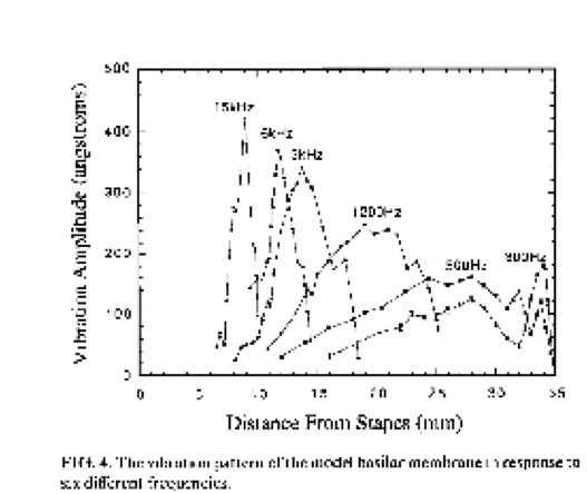

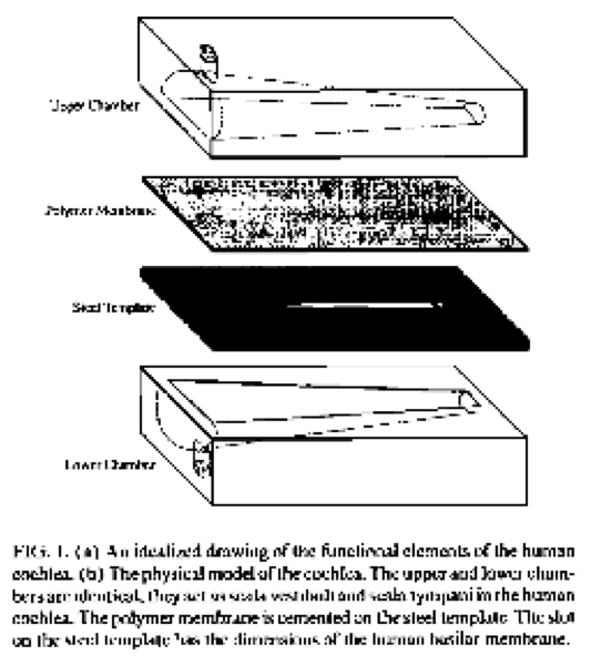

Gan Zhou and I with Dana Anderson once wrote a paper "life size model of the human cochlea with optical readout" published in JASA. The physics of the cochlea were amazing; as you probably know up to 500 hz a WKB 1-D approximation modeled cochlear traveling wave response pretty well; the basilar membrane response is really quite broad. Above 500hza 3-D model is required and the traveling wave ( like a Tsunami ) membrane deflection is much more peaked in response. past ~ 3khz the the cochlear pressure response is very peaked and we found 15khz was about 5mm from the stapes, hence the 25khz or so discrimination threshold for lucky individuals.
Sadly we never ran two tone etc. through the lab cochlea but the 1khz and below basilar membrane response seems really broad for a highly discriminating response to say an in phase 500hz and 1khz two tone signal.
above 3-5khz and it would be pretty localized, so I would guess 2nd harmonic 1khz and below would be threshold limited on auditory response

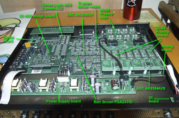

Guess what opamps are used inside the Metric Halo ULN/LIO-8 "soundcards", to many the most transparent sounding pro-audio interfaces they ever got their hands on.
I see more votes for flat mic-pre to DSP RIAA among its users, many converts from some high-end analog pre-amps.
Yeap, that too.
And they use ye olde NE5532 in there...
Cool, that might explain why they recommend a transformer for MC. I guess everything really does sound the same.😛 Does this sound $4500 better than that Behringer?
And is that an SMPSU I spy in there too? 😎 The saving grace I guess is its balanced I/O right? Where do they connect the pin1s - onto the PCB?
