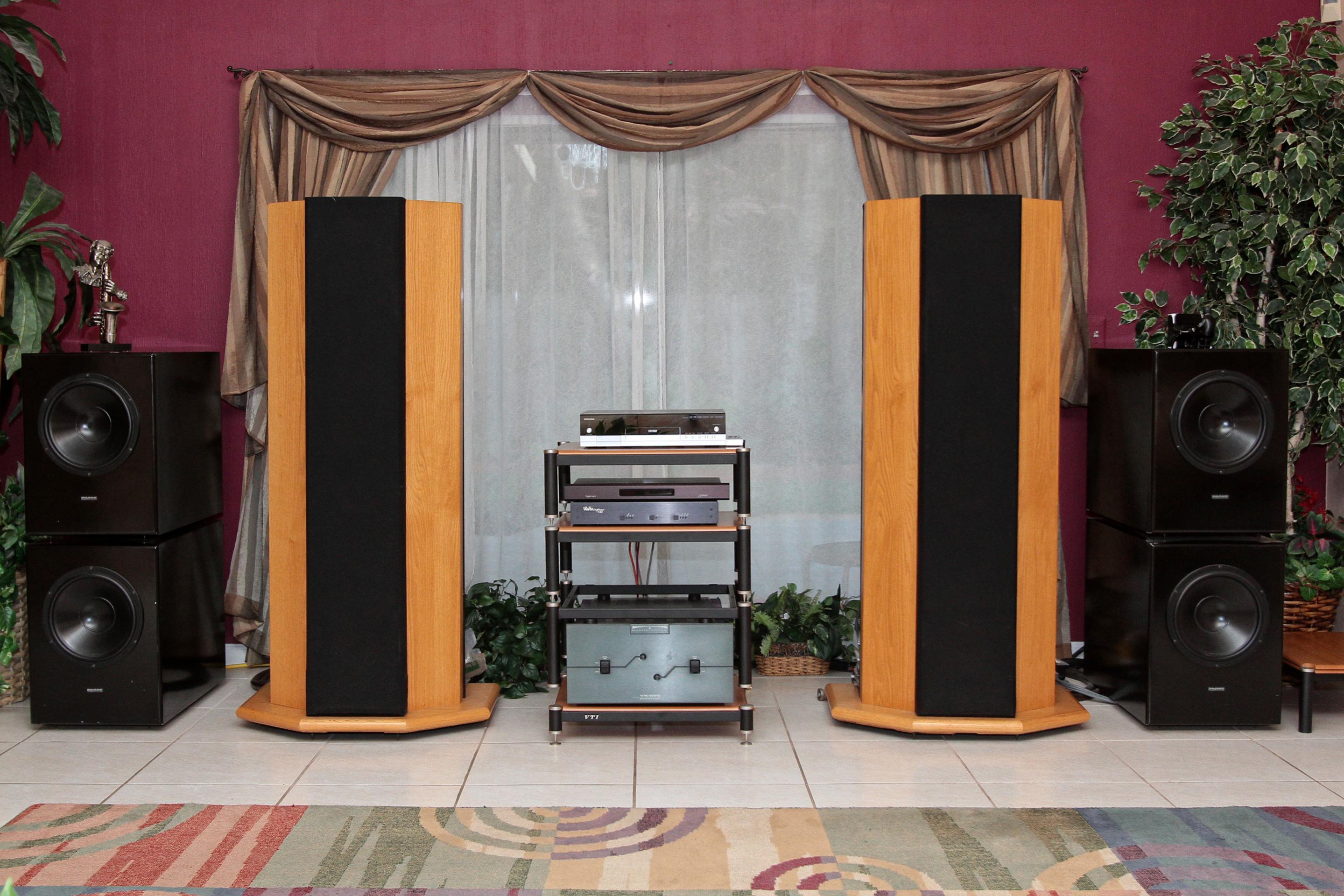

Did my first what is now called open baffle in 76, evolved them over the years by running the bass units in BR enclosures, I cant be bothered with OB bass issues..
SOTA OB setup circa 95/96...
I am curious as to why the speakers are so close together and why they are firing straight ahead. Would this not narrow the effective stereo listening window, as compared to crossing the axes in front of the listener and spacing to achieve the standard ±30º from listener's perspective? I am guessing you have tried this and the configuration you have sounds better.
The picture is a bit misleading, the panels are not in their listening configuration, pushed back when not in use, panels are usually more forward and wider part when listening and there is some toe ( slight) but no, toeing in is not always necessary, unless you have a narrow window of dispersion, or require being on tweeter axis for best FR, plus this is not a point source, it's an Iso-diametric point source configuration OB from 150hz-5K there are also rear firing tweeters ..

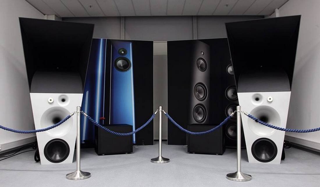

Have any of you actually heard the big Magico's? I have twice. While I like Alon and am really impressed by the enterprise he has assembled I have not been impressed that much by the horn speakers. They are really an interpretation of the Goto drivers. The horn is different and required some customization of the components to get it all working right. But horn's have never impressed me. Its the cloth ear thing I have. . .
