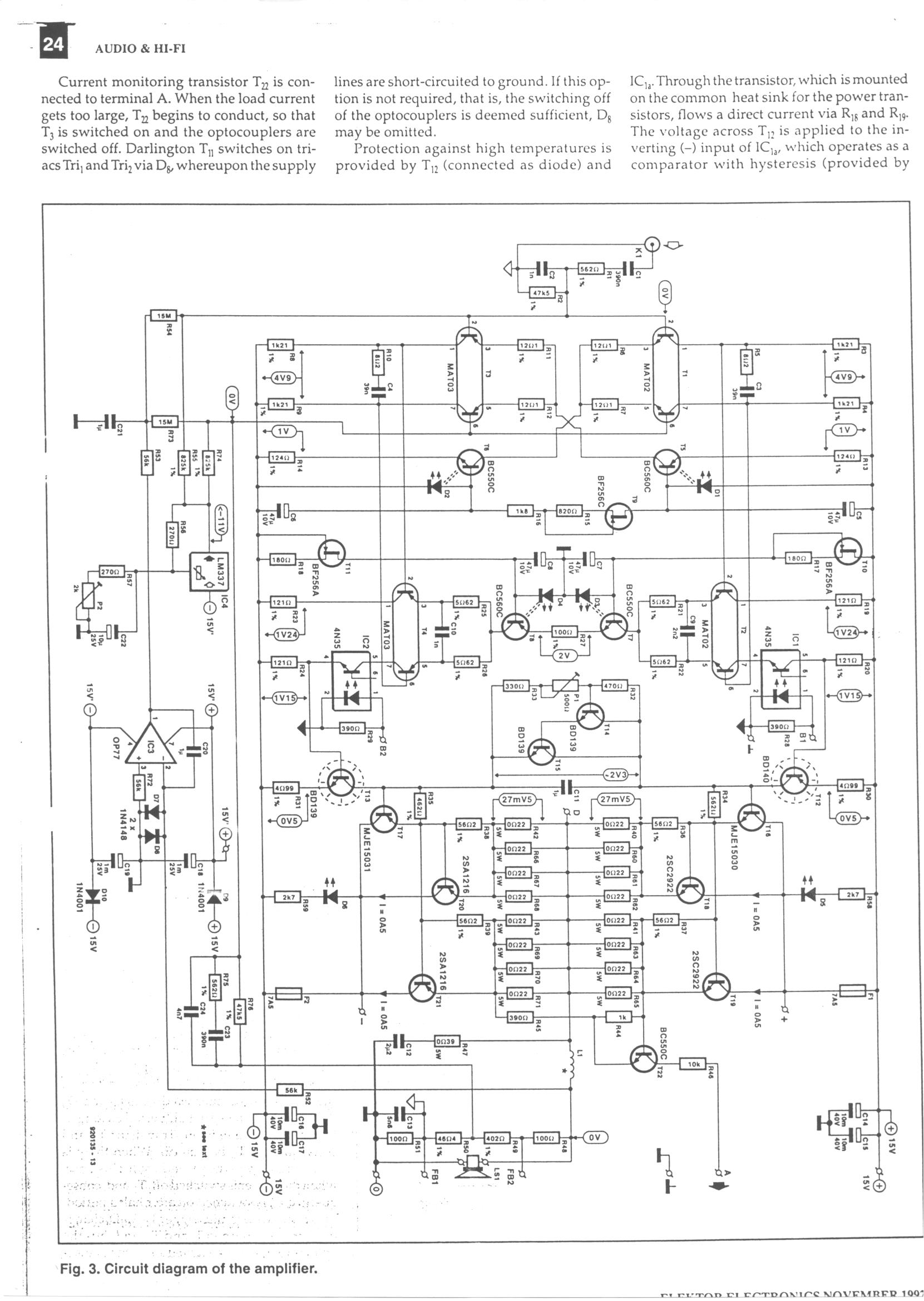

Mr Wayne mentioned an impedance of 1.8 to 1 ohm, in the 400Hz-20kHz range.
Plus a sensitivity of 84dB/2.83V/1m (17Vp minus 20dB would put his average listening level under 80dB/1m, so he's not stone-deaf yet)
He also mentioned 100Wrms for 93dB, which would suggest 82dB efficiency, his last quote was 3-5V rms/continuous for average listening (Mr Wayne even posted 0.85 ohm as minimum impedance once)
20A in 1 ohm, with +/-42V rails, equates to a dissipation of ~440W
A quick class AB heatsink calculation for the 16 output devices, suggest a minimum of two 0.30C/W heatsinks per channel.
(a 0.15C/W value is also relatively in-line with the 0.50C/W heatsink of the Elektor high-current amp for the Decca ribbon : 15V rails, 85W continuous in 1 ohm)

What's to say, a Locanthi triple is less easy to thermally stabilize as a double EF output stage. (and Hfe x Hfe x Hfe is a frigg.. large number
If the output stage is undercompensated by the Vbe multiplier, bias goes up as the OS heats up and you have thermal runaway.
The complementary BD-pair in the Vbe multiplier may compensate for the different behaviour of the NPN/PNP devices in the output stage.
But even glued on top of the output devices, there's epoxy inbetween, thermal resistance between the die of the output device and the one of the BD. Both connect to the heatsink, so thermal resistance of the heatsink to ambient (the C/W) also becomes a factor in the equation.
Idle dissipation of the output stage is ~87W (130mA x 42V x 16)
In case of your 20A out, 440W.
1 : 5 (Jimbo Early effect will also pass by).
Even the Vas current is a factor.
Long story, the OS has to be overcompensated. (overcompensate too much, and distortion will not be pretty into a 1 ohm impedance)
A Vbe (Vgs) multiplier like the one on the schematic is what e.g. John Curl uses, on a MOSFET driver and BJT power device output stage.
For an (all BJT) EF triplet you'd have to think diode strings á la Leach & Locanthi, or enhanced 2-transistor Vbe multipliers that can be (e.g. tempco) trimmed.
Btw, check how poorly a classic Vbe multiplier performs : www.hagtech.com/pdf/vbe.pdf

Jacco,
As we both know, there are many ways to make a Vbe multiplier, far too many to even list. The one I used here I always liked because with some selection of the BD trannies, one can find a matched pair with a Hfe of 120 or better, I've even made 140 on several occasions. In my experience, which may well be smaller than yours, this has enever failed to do the job, and do it properly.
Problems can, and probably will, appear when one uses the BDs with a low Hfe figure, and they can go down to 60, which is too low for most purposes. I have also used MJE 340/350 in the same configuration, but again, after some selection, as they too can vary quite a bit with their Hfe figures.
But, however you look at it, the heat sinks are the key. If they are very efficient, the overall heating up will be less, and vice versa. One of the reasons I'm sure which helped in my never having thermal runaway problems is the fact that I have always used very generous heat sinks, typically 300x40x100 mm German made Fisher types, with main body thickness of 10 mm. Also, I've never done any REALLY hard condition amps, such as pro amplification, when an amp is called upon to dissipate trenedous currents, at relatively high voltages, for long periods of time, I've done only home audio gear, which is never really pushed too hard. On such a heat sink, you can easily fit 4 pairs of 200W output devices plus drivers, enough for one decent channel, and have no problems under normal circumstances.
And, if push came to shove, I could always use the same heat sink, but 400 mm long, for still better heat exchange. Ultimately, I could use forced air cooling as well. It appears Wayne has pre-empted this by obtainig cooling fans as well, so I really don't see how this could go seriously wrong anywhere, worst case being that he gets to hear the air whoosh of the fans when he starts to irritate the neighbors with very loud music. Then, heat will become a problem, but that heat wears blue uniforms and has guns. 😛
